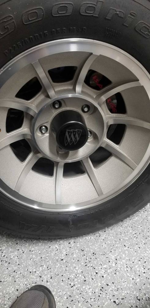

I’m running the 140-12837-d. There great quality. World of a difference over stock brakes. I’m not running stock t wheels but I read of some people doing it.

I couldnt find anyone running them on a quick search. You have any T wheels around to see if they fit.
I know they will fit the GNX wheels

Send a PM to Turbo6inKY. I think he could probably provide some good advice.
For the Bear brakes they say use the 11" on a stock or 15" wheel. But would be interesting to see if the 12.19 would fit.
