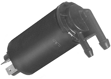

Previous owner had and alky system and deleted the washer system. Need to get the car inspected and need the washers to work. Got the shooters for the windshield and the rubber hose in place. Not sure is the pump wire was cut or is hidden some were. Does anyone have a detailed pic of the washer motor and wire? Thanks
Pump is in the bottom of the wiper motor hsg. Should be a pig tail hanging in that area.
The pump has a small clip holding it in.

anyone got a pic of the connector? have a few orphan wires.
I just replaced mine a couple weeks ago. There is no separate connector. The pump has two spade terminals on the top that engage inside the wiper motor when the pump is pushed into place. Then you pop on the retainer clip and push on the two hoses.
