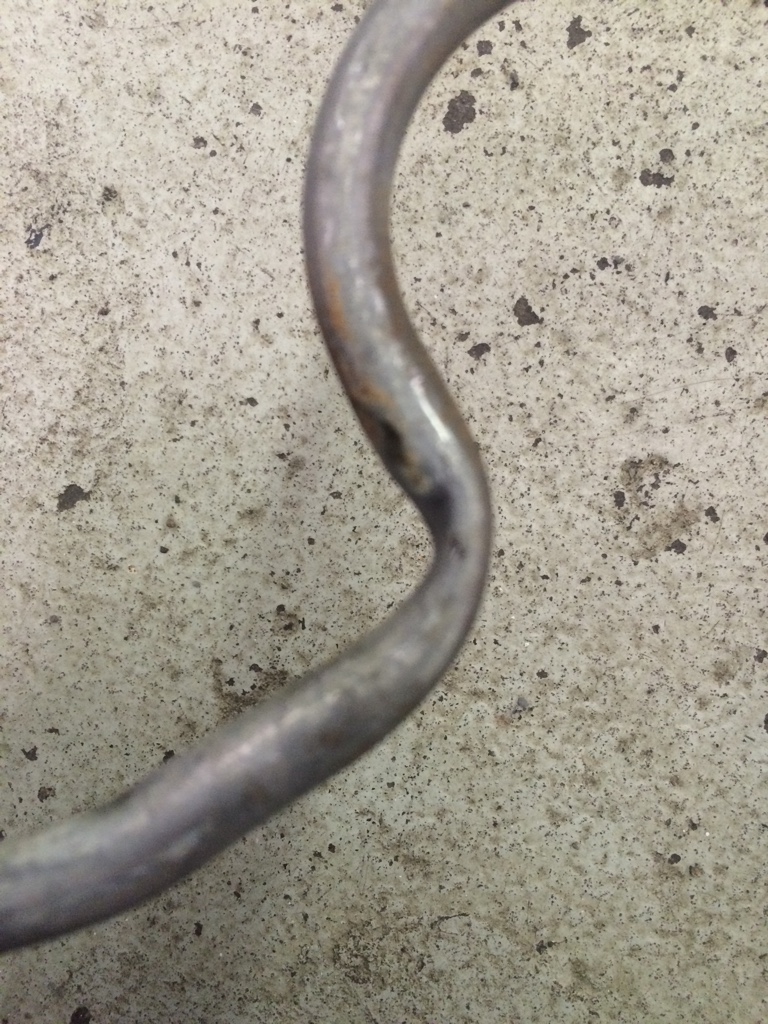

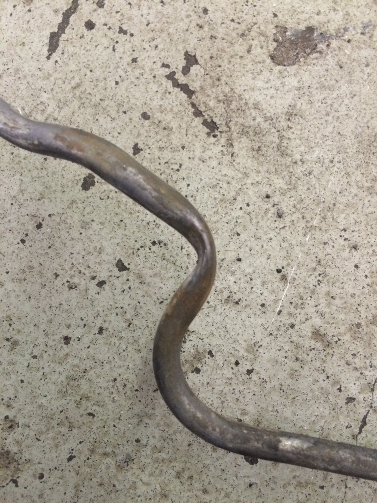

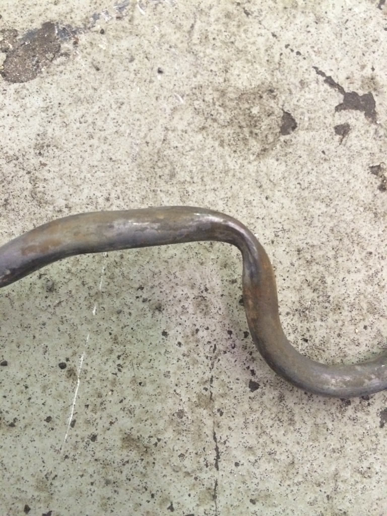

Lol. I knew the Red A 1000hp would pop up. Some can get 1000+hp through stock lines and some can't get 800hp through no matter what voltage they run. My slower car (9.50 power) runs through stock fuel lines with a non AC delco filter. Might even be a Purolator. 100% DC with 3145 injectors and no pressure problems whatsoever 83psi fuel pressure with 34psi manifold pressure. I am sending 16v to the pumps. Other cars can't even come close to that. I never bothered to measure every stock fuel line I've removed but I know for sure some were better in the restrictive areas than others and you surely wouldn't know unless you measured the ones in your car. Not to mention the cars are 30 years old and most beat to hell. I'd also put money on checking AC filter flow. Some are probably better than others. If you're serious about going fast and want a reliable fuel system you likely wouldn't be too serious about running through the stock fuel lines. Do you think this would work in Red's car at 1000hp?
