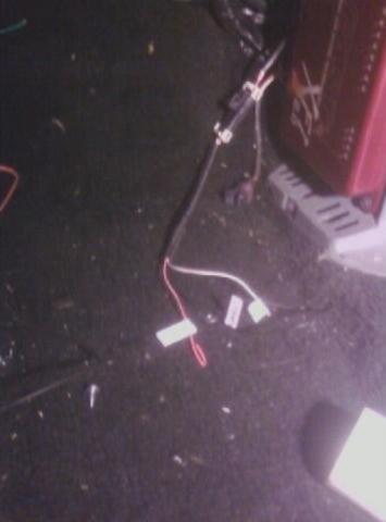

I willl make up a pigtail harness to go into your adaptor harness so you won't need to hardwire it in. It should be able to go out today, just need billing information

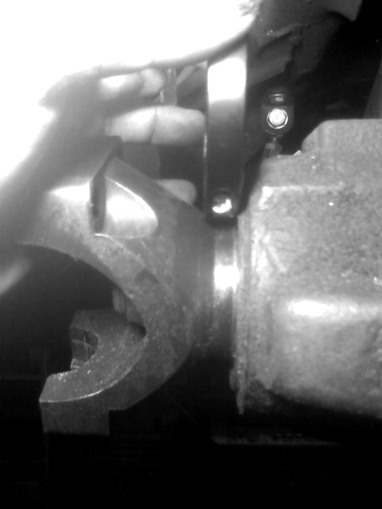

does anyone have picture of this installed? because it does not look like mine fits, the diameter of the collar (1.875) is smaller than the diameter of the yoke.
The collar should be slightly smaller than the yoke. The larger collar is 2.187" . If you need the larger one, please let me know and I will take care of it. Any questions on the harness I made up?
The ring width is wider then i have space to put it in between the seal and the back of the forged yoke. It would be rubbing against the rubber of the seal.
The harness is great it should make the hookup a breeze.
So the diameter is ok, it's the width of the collar that is too big?

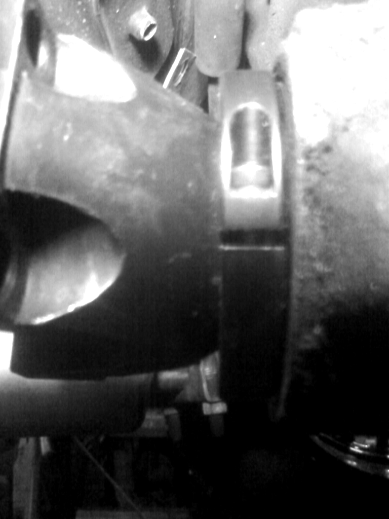

We pushed the seal into the rear more so it looks like the width will be fine. Gonna see if we can use a clamp to force the collar around it.
machined out the collar about .10" , collar still had a gap at ends but its on there tight

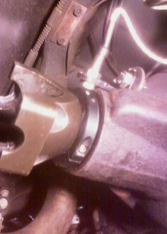

to bolt up the aluminum sensor bracket I welded a large washer to the axle housing on driverside and routed wires along side the flexible brake hose and up to the frame
harness worked out perfect Cal, just made it to the XFI routing along frame rail and then through the old stock engine harness hole
