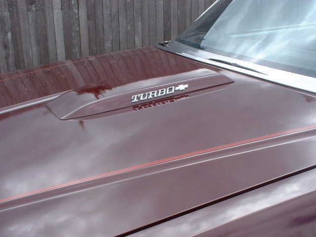

1980/81 Monte Carlos had a bolt on hood bump. They are hard to find, but that might be an option.
Ive got a monte turbo bump laying around if your intetested
Sent via a potato with the sour cream and shredded cheese app
I like the idea of that bolt on turbo scoop, but I dont know a thing about them. Are they functional or decorative? have a few pics MNcarbturbo?

They are decorative. On the 1981 Monte, they are just bolted on with no hole in the hood. If you having clearance issue, I'm sure you could cut a hole and cover it with this. If you 're looking for functional, then I don't think this would be useful. Even if you cut open the back, it's not very tall.
