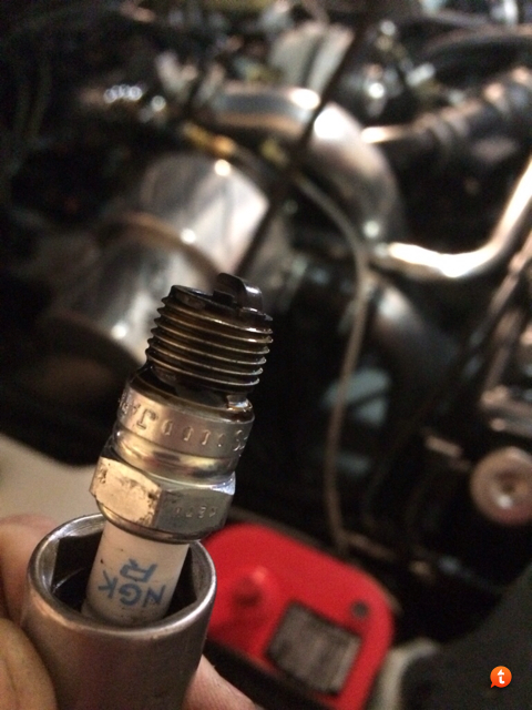

Newish build.maybe 6k miles. #2 spark plug doesn't last 1 tank of fuel before fouling out. The car continues to run perfect but my OCD tells me to check them. All the rest of the plugs look brand new. Changed injectors, coil pack, module, compression checks out good. Valve seals are good, zero smoke. Would the PCV system foul only 1 plug with a rjc power plate? I have a catch can and does catch oil. There looks to be oil coming up the threads but I can't make out if it's oil or unburned fuel. The only thing I haven't done is put new spark plugs wires. These have barely 10k miles and ohmed out good. What am I missing here
