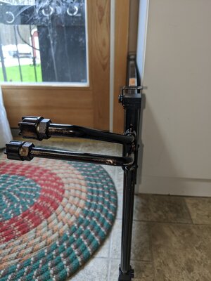

Looking for a new ac condenser. The spectra 7-4013 I bought seams to not fit. The lower ac line hits a panel under the radiator support/ header support. Any help here is appreciated. Shoot me what you got. On lockdown so working away on a 86 GN.;)

Thanks fellow members. The spectra 7-4013 is said to be correct for our car but in my pictures you can see the lower ac line has the paint rubbed off where it hit the header support in picture 2? :unsure::oops:

Every car is a bit different and the tooling for these parts is forty years old. Almost everything is going to be beat to fit and paint to match. Bend the lower A/C line so it's not touching.

;)Thanks turbo6inky. Thought about that but didn't want to break anything, Maybe a real mechanic has a tool to bend aluminum.

I just use my arm. It's been pretty reliable so far.
