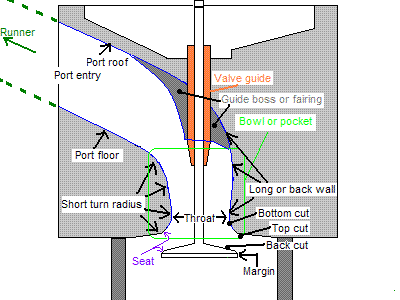

Here is a good picture of the port and its terminology.
Lots going on in a intake port in less than 2 millisecond.
