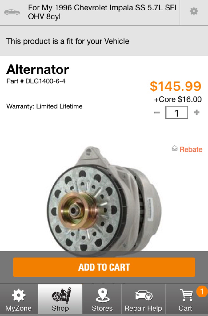

Dank GN , I might give this a whirl.
It's 140 amp for a 95 Caprice.
It's new not reman....I wouldn't run reman on anything jmo.
I believe the bracket on the back of the alternator need to be modded for the Caprice alternator.
This one shows same number but different diameter case...for the Impala.
IMO I would just get the AZ Duralast Gold 140amp instead... it’s 100% new and has a National LIFETIME warranty .... I’ve had one on my car for about 5years... no issues. As mentioned, you don’t use the rear brace
Sent from my iPhone using Tapatalk Pro
I bought the AZ1400-6-4. The manifold to alternator bracket bolt doesn't line up on the back and I can't use the bracket.
Do I really need it?
