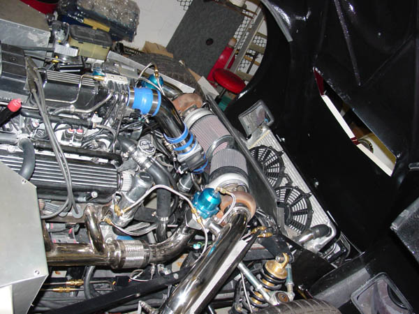

I welded in braided expansion flex joints directly into both sides when I fabricated the headers on my project. Plenty of expansion with two turbos, but no cracks, loose bolts, etc - yet.
That's a nice set up but hard to compare to a twin turbo hybrid. If the header turbo flanges were cracking a piece of flex pre turbo would definitely help but we're talking driver side header here. No turbo or down pipe on ours. Apples and oranges.
