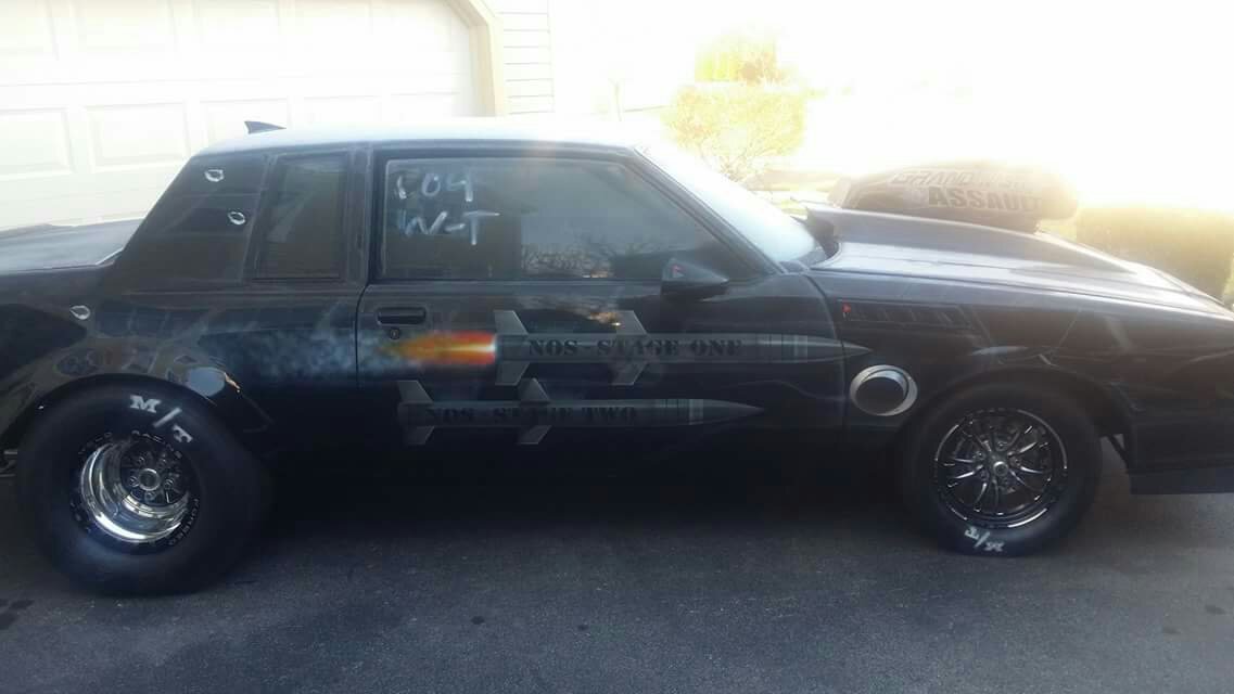

Okay I like to be different and i thought this look was pretty cool but would like to have a qtp electric exhaust cutout tied to the front off the downpipe. Just wondering if anybody has tried this
Personally, I don't like it at all. :wtf: I don't see any advantage to it and also when the cutout is open, you'll be spewing out fumes on everyone standing by the side of the car…:mad:…not nice. I prefer the exhaust exiting under the car or like mine at the rear.

Well, I'll specify my comments from points of view from three different perspectives.
-Purely technical point of view = Serves no performance advantage.
-Logical point of view = Destroys the fender. possible contact with surrounding metal making disturbing rattles. soot stains down the side of the car, offensive odor and direct sound disturbance to other bystanders. Possible fire risks depending on accessories location. If driven on the street, will draw unwanted attention in many ways.
-Designer's point of view (Paint included) = Ugly. Visually distracting. Disturbing to the clean body lines of the fender and classic shape of the Regal body style. Draws attention away from the pure style of the automobile. Too overly childish and playful to be taken seriously. Each individual element (paint, fender dump, wheels) exists on its own, and does not take into account being a part of a total package in context with its surroundings.

You would have to use a sharp Y pipe and go behind the wheel through the a/c box area. You would need to protect the plastic fender well in that area or run no fender wells like I'm sure that example has. For a race car I think it would fine but on a street car you are looking for a host of issues. Not sure there is any real performance gain there. That would have to tested though.
There is no more advantage to running an open downpipe at the fender than there is under the car.
And unless you have some monster turbo on a full drag mountain motor that moves cubic yards of air in milliseconds, most certainly the biggest performance gain might be the weight savings of not having a full exhaust.

I did this back when I was in the mid 90's. My car was running low 10's at the time. I cut a hole in my inner fender to dump the exh in my front wheel well. I didn't go as far as drilling a hole in my fender, but the concept is the same. It made my car sound as though it was on steroids. With back to back tests at the track, I netted zero gains when it was capped up and ran through the exhaust.
This was my fender dump
This was the exit hole in my inner fender..... As you can see, heat isn't friendly on plastic, thankfully my coolant bottle covered most of the exit wounds. The inner fender is now out of my car and another clean factory original has taken it's place. If you are interested, I can sell you my inner fender for you to dump your exhaust there as opposed to cutting a hole in your metal qtr panel.
