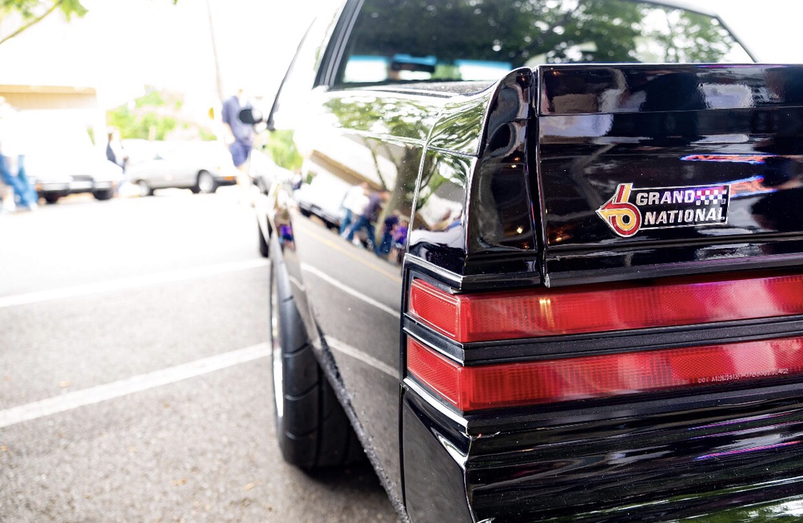

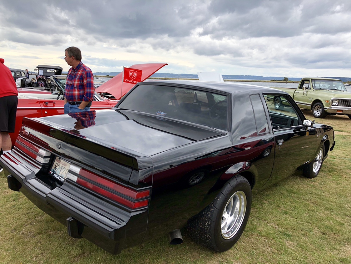

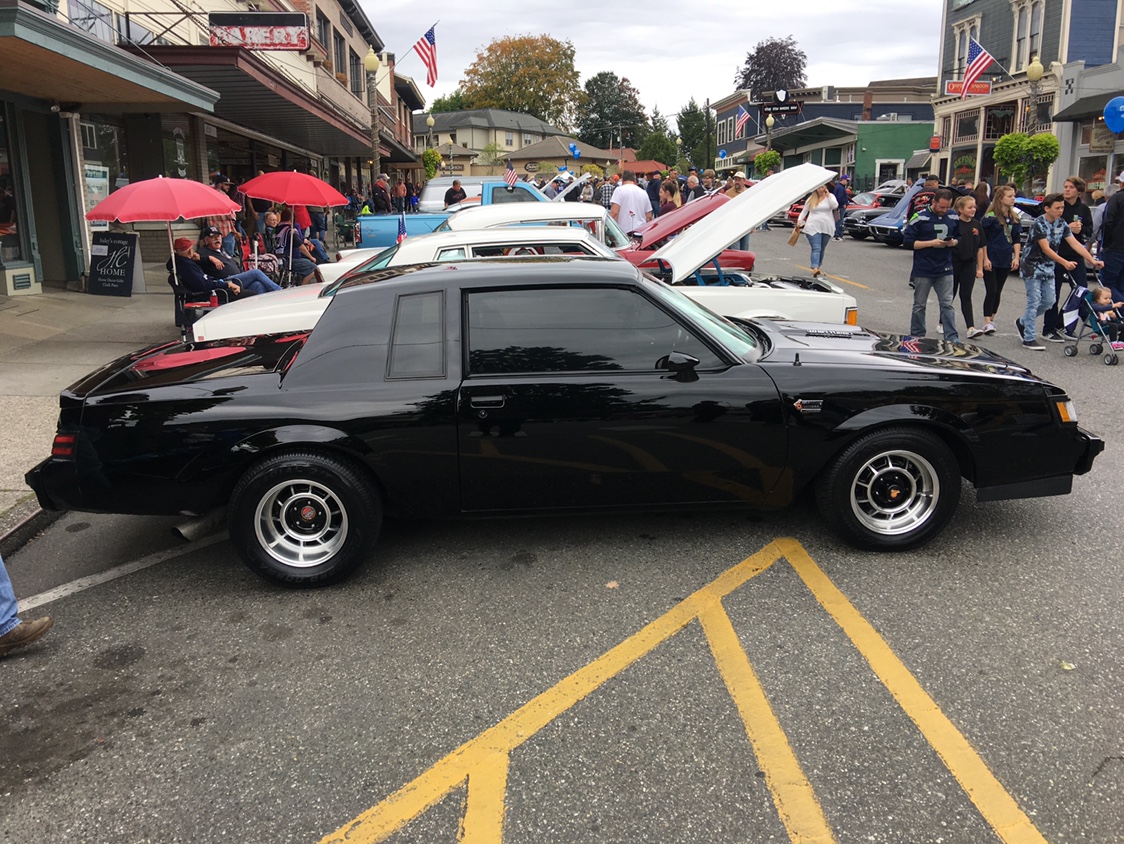

I have a 295 with a 10” wheel with a 4.5” BS and that’s as wide as I could go without notching my frame. I did have to roll my fenders though. Pics with a stock type wheel and a drag wheels.
