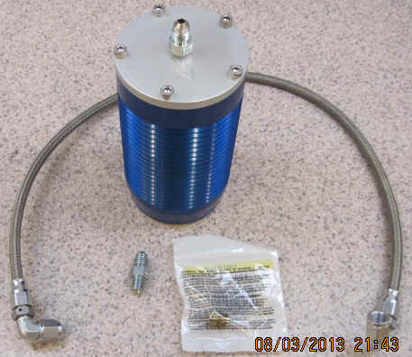

Is it really a must to have turbo saver oil filter relocation kit with ball bearing air cartridge turbos?
The other two cars had 6765 Bb and 6768 HPQ bb and I was talked into oil turbo savers on those
I wouldn't say must have but good to have I run the TR Custom one VERY nice and simple piece
Nothing wrong with filtered oil to the turbo !!!!!
Bryan
That feed restrictor stops up real easy. Filtered oil is good.
http://buickgn.com/turboprotector.htm
I thought being a air cooled center section it wouldn't need oil running through the bearings- not the case?
Thanks- I'm looking into getting a 7175 BB air cooled turbo and was hoping I could get away with not running oil lines but I guess not.
