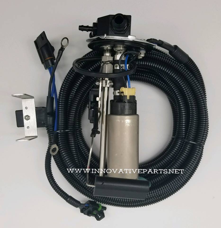

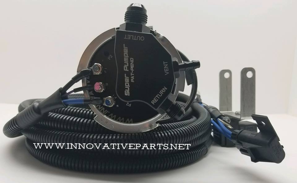

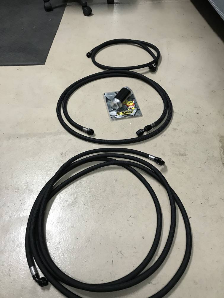

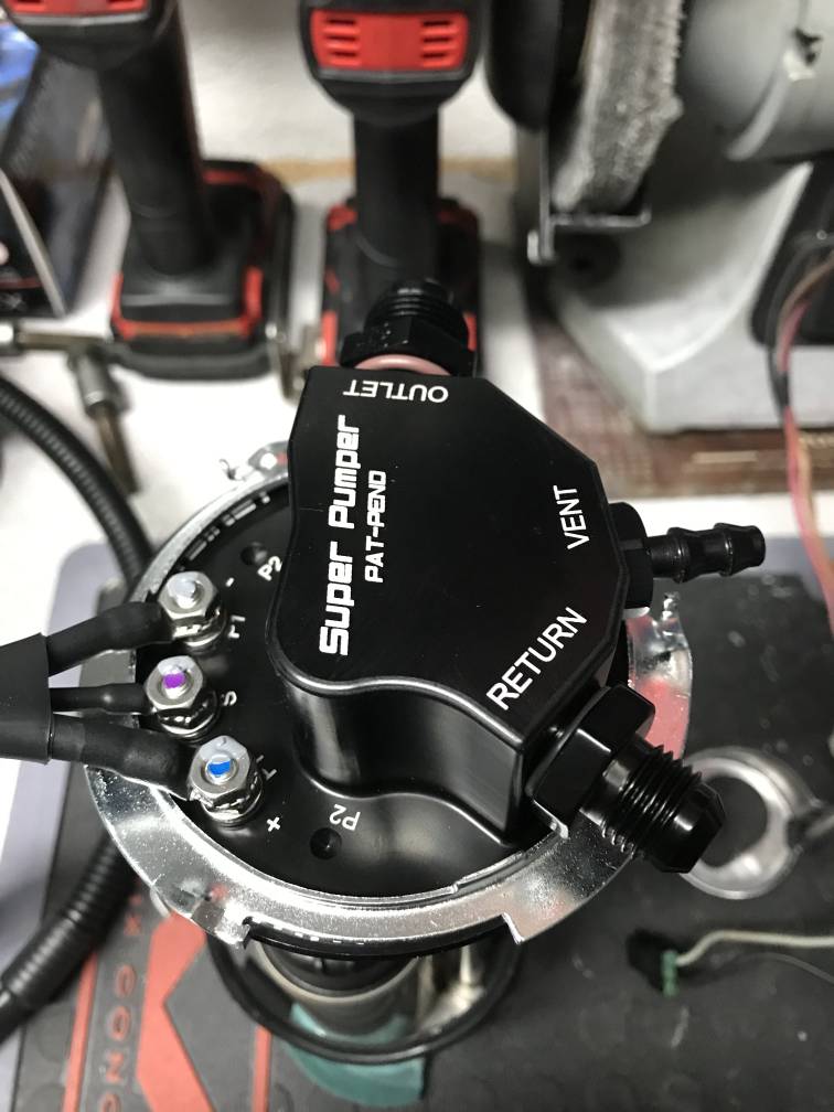

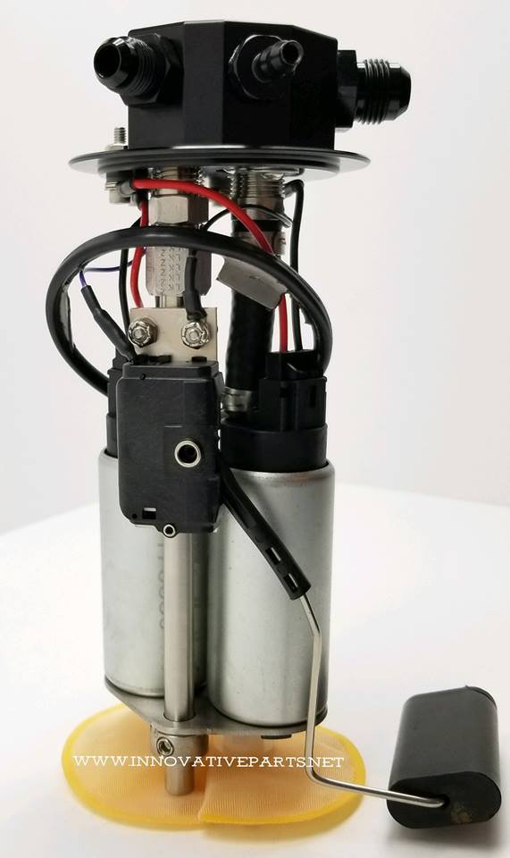

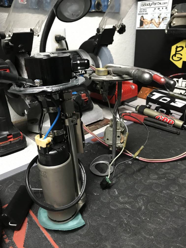

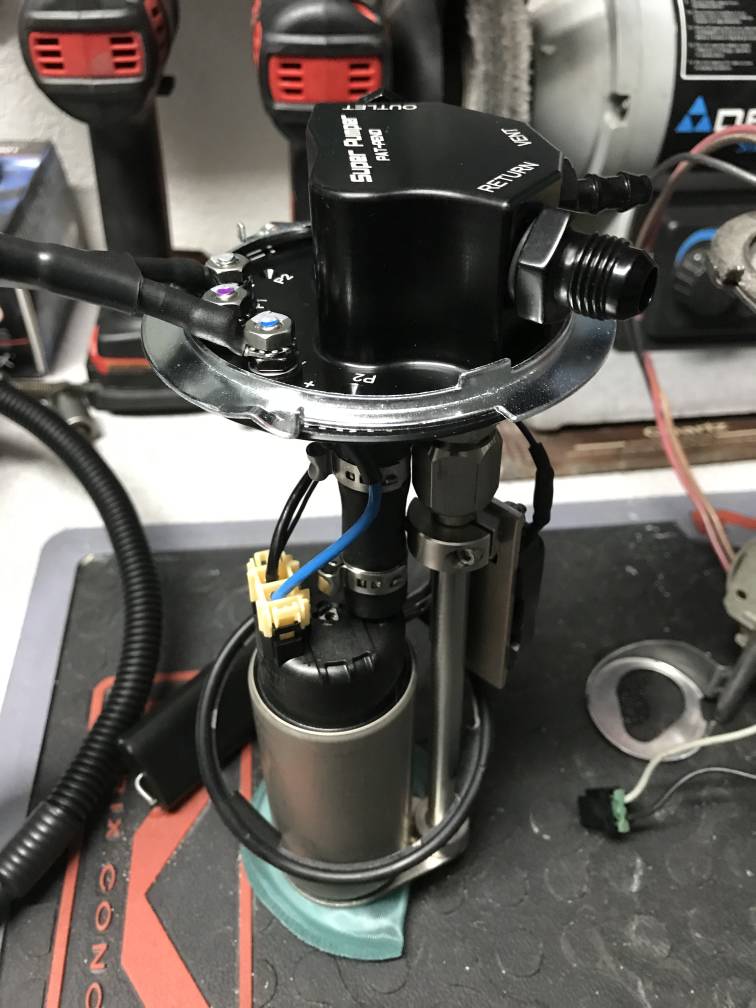

Cheap route would be get a dw 300. Or do it the right way and redo the whole system if you plan to keep upgrading. This system is sweet. Tom just did a post on it. These are some of his pictures
I just love this set-up!! It just speaks high quality all the way.
I just finished up my car switching to E85. I went with the DW400 and the new wiring harness for it too. The goal on my car is 700 to the wheels. I did go with -8 feed line and -6 return too.I have not tested yet but preliminary runs are very promising.

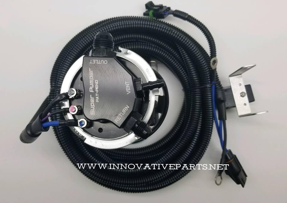

I did a complete build on a locals car this year. It was just a shell with a tranny and a bunch of stock parts in the trunk. The motor was built with a reliable hyd roller setup, ported heads, intake, front mount, converter etc. After I got the car running, I told him to just put some miles on it and to stay off WOT till we get a good fuel system in the car. My customer drives this thing everywhere, as the car still has cold blowing AC. I installed a Racetronix double pumper in it with a line kit at Racetronix. We made 500rwhp at 19psi on straight pump gas with no alky (still has the stock computer with a Turbotweak chip).
There will be a video coming out soon on this complete system in the early portion of the New Year. We videoed the complete install and have a in-depth break down on all the parts associated with this system along with the proper way to install it. There is nothing left for interpretation, and you get the full technical break down on it's capabilities. This product has a very broad scope. It will work well in a 11 sec street car all the way to a low 8sec GN with no issues. I personally run this same system too and have run low 9's @154mph with a 68% duty cycle in a 3,700 pound street car. Big single pumps are fantastic, no doubt, but there's also another element that isn't touched on much. On a street car, big pumps heat up the fuel quicker. After a 45min to 1 hour of straight use, the fuel gets extremely warm. That in my opinion is where a double pumper shines. One pump runs until the next one is activated which keeps less heat out of the fuel and preserves your fuel system.

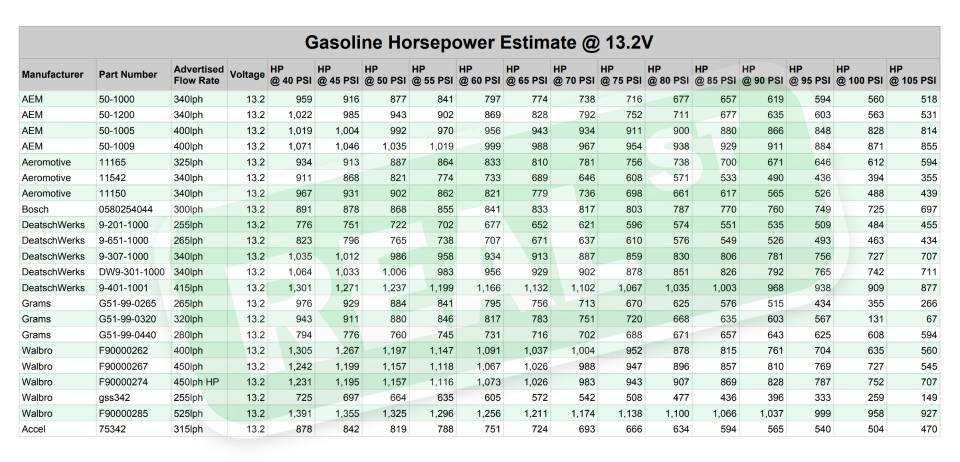

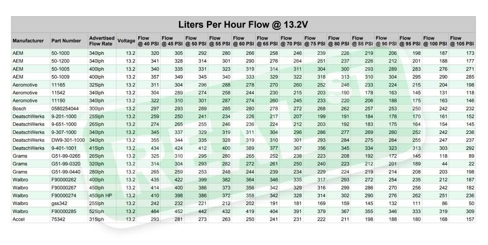

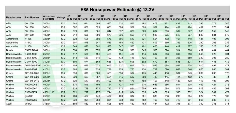

Better fuel pump chart
