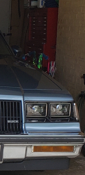

Well I think I'm going to go with the Eagle Lights (part# 4600B-4) which I posted in post #5. I spoke with Dave ("1KWIKSIX") and he said that they were very similar to the ones made by JW Speaker which he has on his car but at a fraction of the cost. They are also the ones "motrhed87" has on his car (seen in post #15) and he said he "couldn't be happier"!

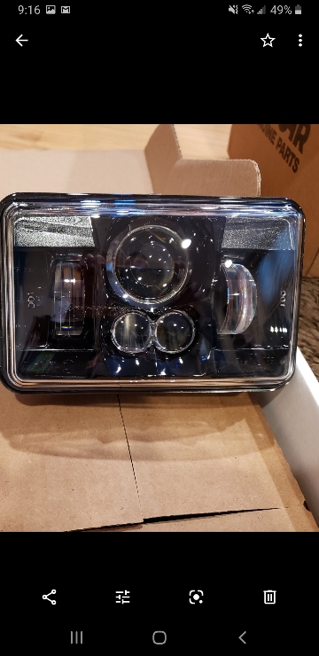

Anybody ever have this problem when upgrading headlights? I'm running "united pacific" black headlights. 3 prong outside low beams and 2 prong inside high beams. I can only get either the 2 outside lights to work or the 2 inside lights to work. I cannot get all 4 to come on at the same time? I've attempted to switch every wire position on the low beam with no luck. I've tried adding load resistors no luck and also added Kirbans upgrade harness no luck?????

The lights are already installed and both sets of lights come on and the brights indicator is about half way illuminated and when i turn the brights on the center light comes on the bright set and the indicator on the dash is fully illuminated.
Since LED’s draw less power the car thinks a headlight is burned out, warning you by the dim high beam indicator. I have the same problem with my ‘94 Cutlass Supreme convertible
Newer cars require a can-bus compatible LED so you aren’t reminded with the “headlight is out” alarm.
I would think yours would be built to work just fine. Hmmmm.
