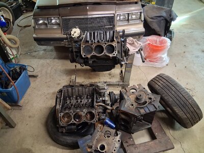

Picked up another complete engine to help get the Regal back up.
An '83 turbo 3.8, I'll strip it down and make it the new blowthru testing mule.
Need to check the bottom end but I have two sets of Speedpro steel piston rings to use this time, it will get the 206 roller cam setup and topend from the hurt 109.
This will be better than the current mishmash of parts I was putting together in a 140 block but I'll still build that too as spare engine.
While it's in good shape the new to me engine has bores enlarged more than I prefer.
It's .040 over, so I will to use it as is. It had GM shim steel head gaskets on it and cylinder 5 was leaking some water into the bore.

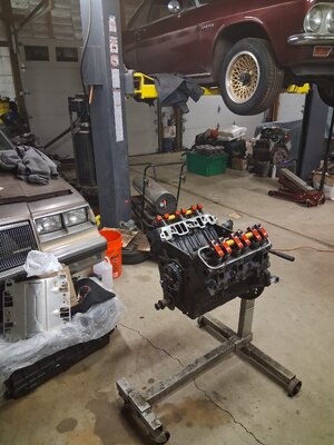

The heads are back from shop with fresh gasket surface, that's all I had done to them.
Waiting on: turbo oil drain kit, GE silicone for RJC heads gaskets.

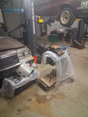

I was at a car show earlier today with my V8Vair but spent the rest of the day in the garage with the Buick.
Nearly finalized now, I'll need to weld a crack in the passenger header I found. Once that's done that will be installed so I can figure out where to add the turbo drain into the oil pan.

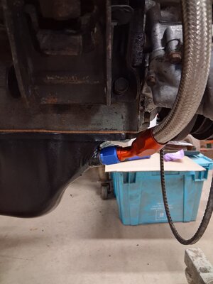

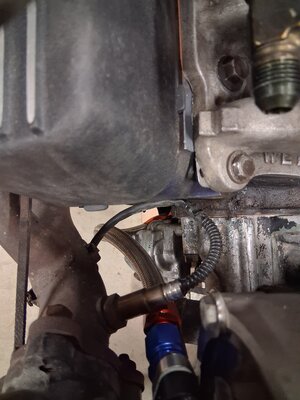

Fixed the header crack, made a steel fuel pump block off.
Now onto getting the drain and oil pan sorted out, I don't remember how much clearance is at the pan and crossmember area.

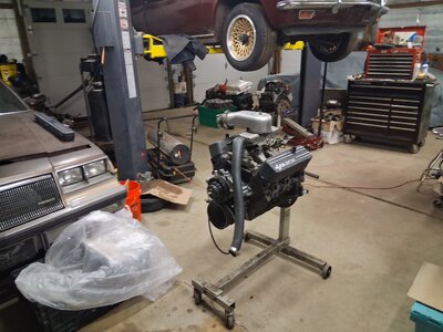

Finished up! I hope it fits 😄 I'll pick up some fluids now and get this stabbed back in the car after oil prime.
