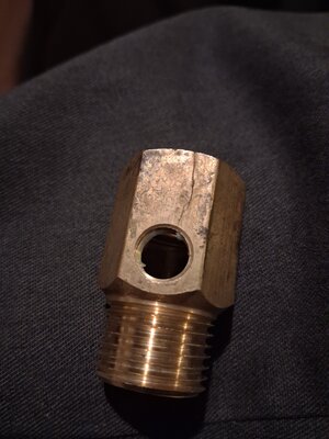

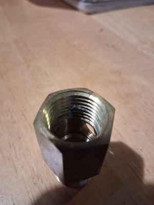

Testing the Alkycontrol system and found a leak on the updated filter and pressure switch assembly. Unfortunately came from Alkycontrol like that I didn't build it.
Easy fix though 😄
