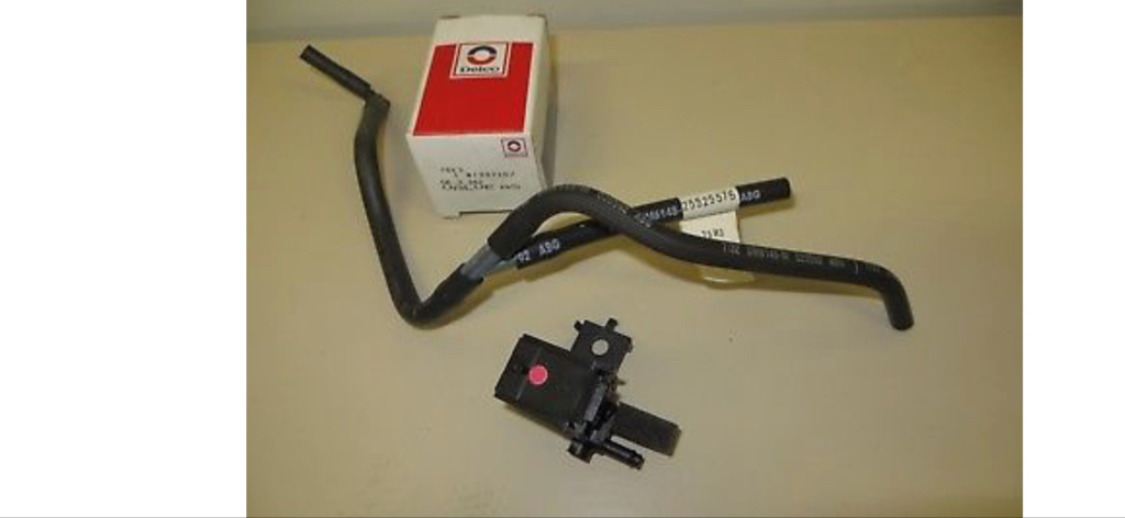

Left end went to wastegate solenoid and one line went to wastegate actuator and other side went to compressor housing on turbo. If you’re going to use stock setup it’s important to get the lines in the right place.

that wastegate line assembly was discontinued Oct 2011 for the US market (Feb 2009 for Canada). just looking around at what's available for you...the pic that Scott posted above of the lines and solenoid is from a current ebay auction for $334. :eek: the hose is date coded February 5, 1992.

in an effort to stay stock (and factory appearing) there is an original grey plastic "Y" connector on ebay for $22 shipped. seller is not me but he is a good seller and I've bought stuff from him before. see ebay listing here. no offense to Kirban's but if you can find an original part and you are trying to keep your car looking that way....
for the rest of the wastegate assembly hose, just get some 7/32 line. If you want similar GM hose markings, check you local dealer's parts counter guys for a foot or so. Find the plastic 90* fitting from the HELP carded blister packs at your local parts store.
remember the restriction in the "Y" is in the straight section, the longer hose with the formed bent end and connects to the brass fitting on the turbo's compressor cover.

actually two sizes - 5/32 and 7/32. that plastic 90* fitting is a reducing fitting. need a 1-5/16 inch piece of 5/32 hose to connect to the boost solenoid. so the plastic 90* is a 7/32 to 5/32. if you can't find one, make a post in the parts wanted. anyone who changed boost control methods probably have the old hose components in a mason jar on their workbench.
those lines from 1992 as NOS may be fine. I have a few NOS ones dated 2002 on a shelf and the lines are soft, pliable and not dry rotted. they have not been exposed to heat, sunlight, or hot oil vapor. the ones in my pic are from 1991 and are fine but I don't drive the car--only added 4000 miles to the odometer since 1992.
it was the long line attaching at the brass fitting that would get soft and oily and decompose at the fitting due to the hot oil atomized in the compressed air, sucked from the passenger side valve cover via the factory breather connected to the inlet bell. while you have it capped at the bell, the throttle blade in the throttle body can have a nice dark oily coating. and the up-pipe from the intercooler to throttle body can have an oily film coating the inside. if you take out the stock intercooler and turn it upside down, you might get a shot glass of oil to drain from it. as you go through things, maybe someday check out the intercooler and mix up some simple green to slosh around and degrease the inside of it. attach a shop vac hose in blower-mode to dry it out afterwards.
