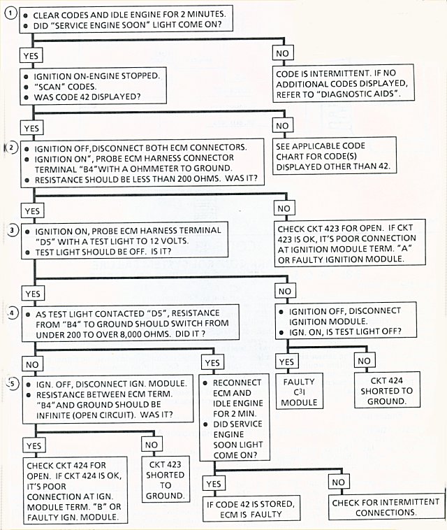

Ran the trouble shooting tree and it pointed at ignition module. 2 duralast modules, same problem. Today I installed a highway stars AC Delco module, same problem. Cleaned the ECM connectors and checked ECM pins. Removed and reseated TT chip. Same problem.

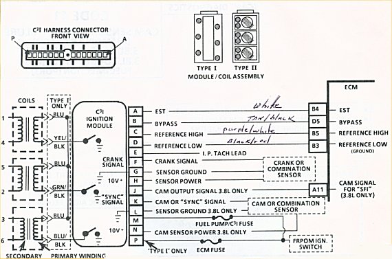

Pin A and B on the ccci harness are not shorted via test light. Ohmed to .3 and .4 ohms respectively with ECM and ccci disconnected. The meter had an extension wire to ECM connector and ccci harness, they were tested at the terminal, not puncturing the wire.
Bad ECM? Not sure what step to take next. It starts with no issues, runs but not the best. Code 42 and check engine light pops up within about 10 seconds. Did the same thing with every module. The ECM is a reman of unknown origin, but drove great for maybe 10 hours.
That is the tree I used, never got the switch to 8000 ohms. Looked for an open circuit or grounded wire on the est and bypass wire, they tested fine.

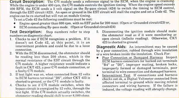

it looks like step 5 is your brick wall and 424 and 423 is where it starts

I borrowed my wife's fluke meter and got the same results. White, and tan/black wire ohmed out to .3 with ECM and ccci disconnected. Ran the tree again with an incandescent 12v test light and got the same results. Module will not switch from sub 200 to over 8k.
A previous module had the test light stay on, the Delco one I just installed didn't do that. 3 bad modules in a row or am I missing something?

the incandescent test light is the correct tool.
Meter is reading 200 at B4 white wire.
Test light hooked to ground. when you make contact to D5 the light should light and it should switch to 8K
this is done in the car at the ECM. if it doesn't switch. to 8K
Then go under the hood to the module
hook your meter to A connector it should read 200 if not you have a open between A and B4. if you do then
with test light to ground touch the B dose it light ? If not you have a open between B and D5.
you can now hook the test light to 12V touch B and it should switch.
clear as mud know?
