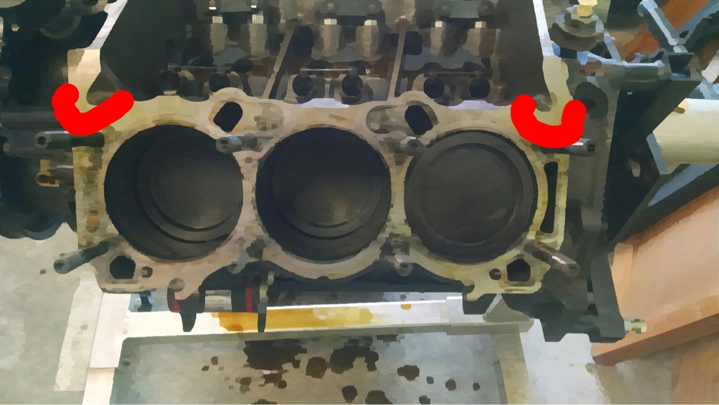

Pics of the gasket when I removed the head.

Rtv thin smear:
I'd do in between the layers in this area also. The oil won't have a leak path if done this way. You need a tiny bit. That's all
I used to copper sparay the cometics, and they always leaked oil. I now do what Bison said, small smear of ultra black on both sides of the gasket. I never had a coolant leak. Could be leaking out of the stud, GM Cadillac tabs seal that up.
I really liked the cometics if they weren’t leaking. You do not take the gasket apart and apply between layers correct? Just buy new, right out of the box, RTV both sides at the upper corners?
