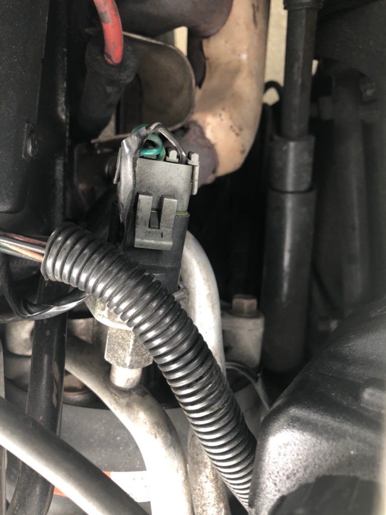

Try unplugging these one at a time. Coolant switch under throttle cable area and pressure switch on a/c.
ok it was the coolant sensor under the throttle cable
I believe that one is the high temp override the expensive one
Just unplug it for now. I wouldn’t bother replacing it because it only triggers the fan at some crazy temp like 220. If you want to replace it I would find one with a lower turn on temp. Should be able to find one that is the same physical size that comes on around 195.
