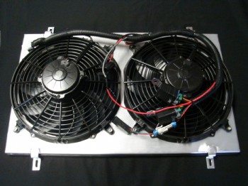

Peter, just got done designing and field testing some new fan setups that really pull air. Here is some specs:
A/C ON test (stock fan / new Alradco dual fan setup ):
60 MPH cruise for 20 miles: 203/191 Improvement was 12 degrees.
15-35 MPH residential with stops for several miles: 212/193 Improvement was 19 degrees!
Idle for 5 to 6 minutes: 218/189 Improvement was 29 degrees!!!!
http://alradco.com/index.php?page=s...n=com_virtuemart&Itemid=29&vmcchk=1&Itemid=29
Now I believe with his aluminum radiator, the temps are a bit lower.......
Also he is a great guy to talk to and help you out.

There is also a set up through GN1 with spal fans http://gn1performance.com/proddetail.asp?prod=ASuperExtremeRadandHoFansCombo
Anyone have that set-up?
