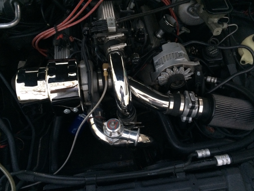

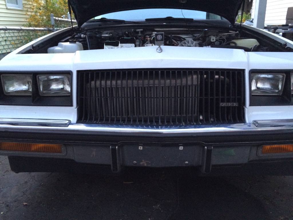

This is an Ebay one I installed on DWALL's car during the build. Although I agree it doesn't have a huge amount of effectiveness because the air doesn't cross a large scrubbing surface, it did do a great job for the $200 in cost. I'm more than likely going to use a regular style core but will need to find pipes.
Actually, for what I'm doing I could use a simple stock IC. But I hate having it sitting in the way in front of the engine. Otherwise it would definitely be used.
