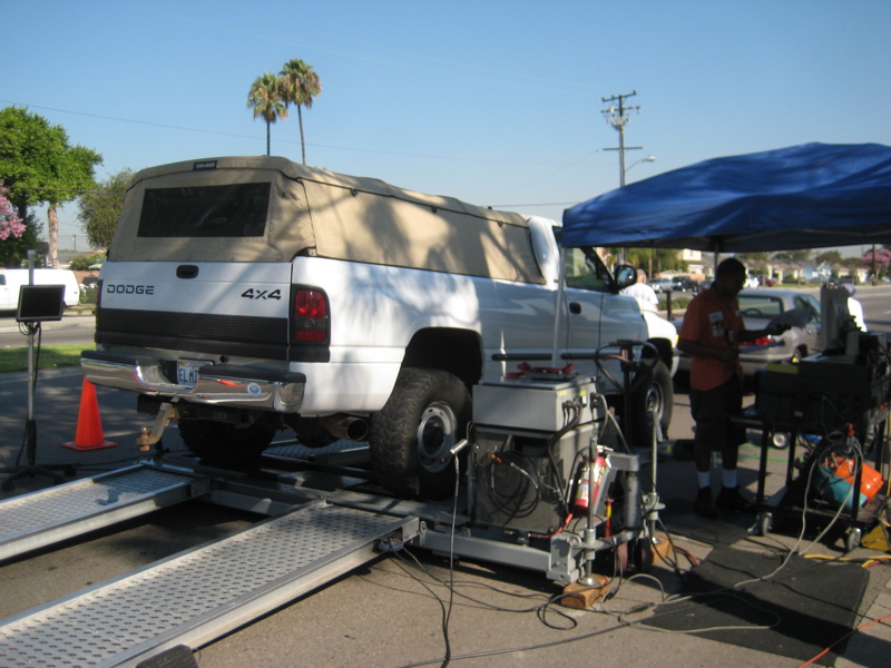

In CA, this is where things are going...
If you can't tell, its a roadside smog checkpoint. :mad:
