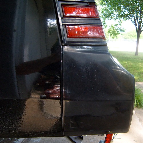

What is most offensive in my pics is the finish. If I sanded them and painted them and put them on as is (even with the overlap on the seam), 9 out of ten people would say it looked good. I get thumbs up with no fillers.

I would rather have the ones I got. It won't be a big deal to fix. I will take pictures.

I removed the flange that connects the filler to the fender, cut away excess material and then reattached the flange with fiberglass using polyester resin. (Thanks, whitehot84 for that tip!)
It went smoothly. After it cured, the reattached flange was rock solid, and because of the location there is no visible seam.
I managed to get the flange back almost perfectly. I will have to do a little bit more fitting and some sanding. I was conservative with my material removal and so it is still a little tight.
I took a few pictures of the process. I will be finishing up tomorrow and I will post them up. It was easy enough that I am thinking about making it one piece. First things first though.
Before :mad:
After :)
