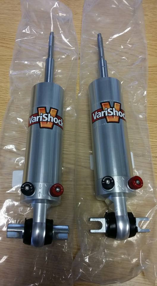

What kind of spring length/diameter/stiffness are you guys using on the front? I have the stock springs on the front right now and would like to lower the front end an inch or maybe even two? The car will have stock style suspension, not coil overs. Looking to get the springs from here if possible. I attached the best pic of the car I have that shows how the car currently sits height wise.

I have done a few low 9 sec. Regals including mine, and a couple 8 sec. builds which are still street friendly.
None were lowered.
For the front, I use non-AC early front Regal springs and just basic gas shocks, stock lower arms, and the G-Body tube-type uppers. Tried the TRZ lowers once, and the went into the scrap pile.
For the rear, I use all H-R products and the must-have item is the anti-roll bar. The rubber bushings on top of the housing are replaced with spherical bearings.
Springs used are stock rear GN replacement, not load levelers. Shocks are 50-50 drag shocks.
The rear frame brackets, upper and lower, must have reinforcement brackets welded in place.
Also, a 2" steel pipe is welded to the across the frame at the top over the axles.
The trans crossmember if firmly bolted in place without the rubber spacers, and the frame reinforced there too.
Of course, a full cage is mandatory in my experience with a 9 sec. ride!
