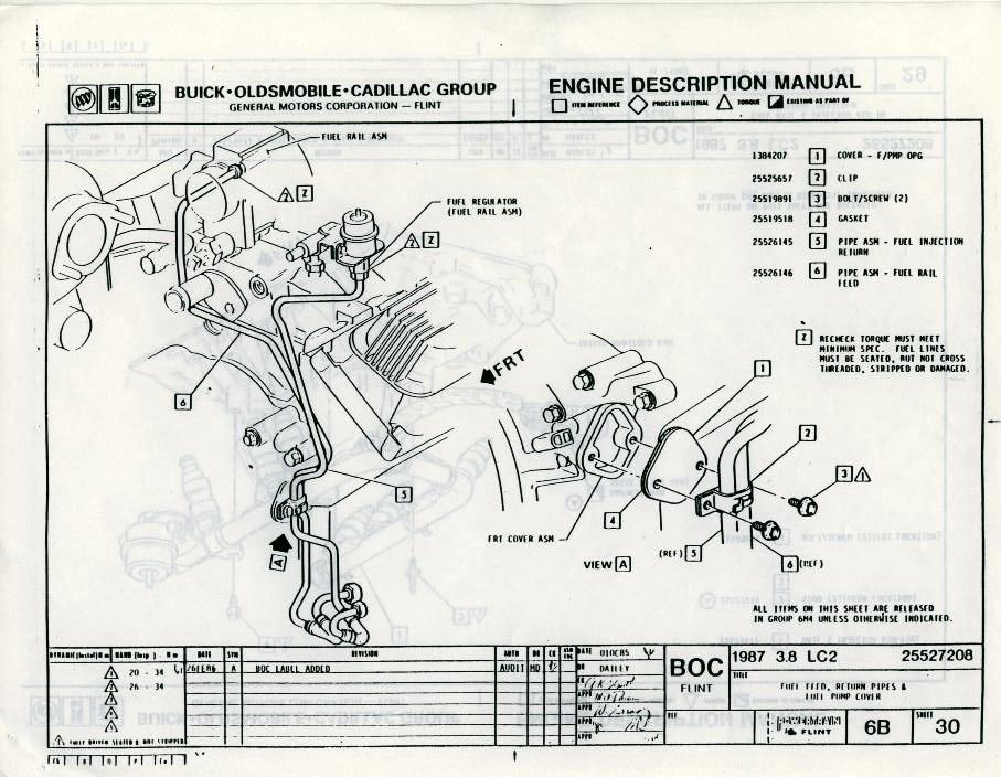

My factory return lines are not damaged. It may be from those factory (saginaw? however you spell it) fittings. They neck down way smaller than 1/4" inside. Looks like 1/8 or 3/16" at most. Or it may be an obstruction. I don't know and don't plan to diagnose it further, i am going to put a larger line on as this problem would only be amplified when I get a stronger pump.
Ttype6, i was on the same thought process as you. I thought surely this 255 LPH pump is not overpowering stock fuel lines. Thats why i was checking everything else first. But the problem is somewhere between the lower fuel fitting in the engine bay and the other one above the rear suspension cross member. And no signs of a dent or kink in the lines. Rubber replaced.
In other words, I bypassed those fittings completely. Hope this makes sense. You could not fit a a Q-tip inside them, they are small inside.
I this fuel line was the only line on the car when i got the pressure down as low as 30psi. I took the return side and just let it drain into a empty fuel jug i had. the fitting that attaches to this one is the one that is very small.
I did take the flex fuel sensor out of the equation. it made no difference. Its 3/8" ... the inside diameter is larger than the outside diameter of the oem return line.

Yes,and one of the most likely restrictions was or is staring you in the face. Stick a spinning drill bit into the front of the steel return line and report back. Again,it would be wise to remove the sensor and re do your first test. This will tell you if you have e restriction between the front of the return line and the sensor. If you don't,there is no need to drill the front Saginaw fitting and you'll know the restriction is farther back. It is also worth sending some compressed air through the return line to the tank. Remove gas cap for this.
That is the hole that you will enlarge. There is another Saginaw fitting like this where the rubber return line attaches to the regulator. I think it is a little larger,but I'm not sure.

For anybody wondering. The inside diameter of the oem fuel fitting on my car measures 5/64"... even smaller than the 1/8" I anticipated.
Car is fixed
I cut off the oem restrictive fitting and used the larger 5/16 vapor line. I now have full control all the way down to mid twenties psi fuel. The modifications took about an hour.
