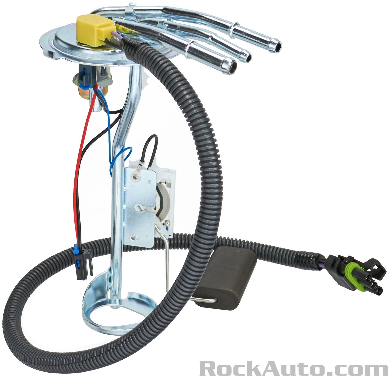

ttribejr, Just something to check. If you swapped the return line and vapor line, i belief the vapor line goes and stops at the top of the hanger in the tank and the return line (which is your new vapor line) vents lower into the tank. correct me if i am wrong but i heard it is smart to modify the vapor line with a hose that runs deeper into the tank, is why i held of doing this. but it sounds like it is working for you
Interesting point, and I think it is correct. This is the factory sender, and the vent appears to be at the top. Maybe switch the vent line coming off the frame to the vent line on the sender. He may have done this to be safe. If not fuel may stir and aerate if the tank is less than full.
Now that the idle fuel pressure is resolved, you will need to take a look at the pressure at max volume use. The ambient pressure in the tank will drop at max volume since there is less return to the tank . . and delivery may become an issue if the vent (return line) is too small.
Also . . I wouldn't run any lower than 1/2 tank due to aeration.
TT could have reburned the chip for the higher base pressure, especially since the car is on e85.
I used the oem return line on the hanger. I cut off the "necked down" so it's 1/4" stray through. the vapor line on the hanger is still vented to atmosphere. I plan to throw a carburetor filter on it just for good measure.
