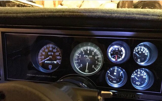

You are right these gauges are not lining up at all. Did you slot the 4 gauge hole and move them to the left, or slot the cover and move it to the right? I did take the speed o apart and paint the inside of the case white so that it wlii brighten it up some. My friends 87T has the dash from Poston and although it looks very good, it is very dim at night almost not readable. It hjas the VDO gauges in it. Also my gauge overlay did not come with the silver pin stripe around the edg that the rest of the dash has and that yours and the GNX has.
ACTUALLY I DID BOTH. I MOVED THE SMALL ONES TO THE LEFT,MOVED THE BEZEL TO THE RIGHT, THE APPLIQUE TO THE RIGHT, AND HAD TO REPLACE THE SMALL STRIPE AT THE COLUMN OPENING...THE BACK SIDE OF THE GAUGE SURROUND HAD TO BE GROUND DOWN IN AREAS SO IT WOULD FIT FLUSH AGAINST THE FACE OF THE GAUGES. I USED SOME WINDOW FELT AT THE OPENINGS OF THE LP POCKETS...IT WAS A PIA TO SAY THE LEAST. NOT PERFECT BUT I CAN LIVE WITH THE END PRODUCT NOW..
Yes my dash kit didn't come with the boost and oil gauge. So Moterworks sent out a set they had found. The oil was correct but the boost was some very cheep Garret gauge. I have located the original style but it's not orange/green. But Pete has said he has one and will send it. But so far I'm still waiting and my car is tying up someone shop.

Hi I have finish my GNX dash install and fixed all the issues but just noticed that my VSS is not working , I see you are having same problem. Have you figured yours out yet?
I HAVE NOT LOOKED AT IT, BUT WILL DO SO SOON..
The GNX speedometer was modified with a slot and the background was painted white...this allowed the stock sensor to work. Hope this helps

The slot in my speedo is not as wide as the one in you pic and there is a small plastic spacer on a stud that the sensor is mounted on. I was wandering should I widen the opening and lowere the sensor to the wheel to see if it gets a better signal?
