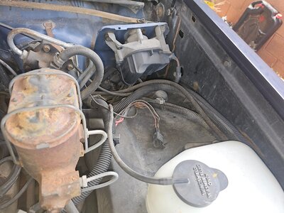

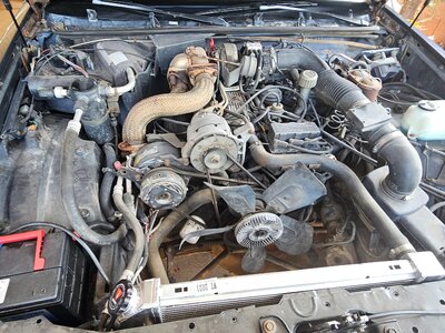

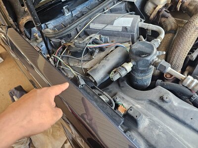

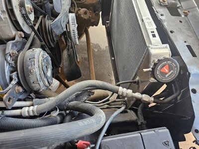

Hi everyone I purchased a 84 t type . It has an aftermarket radiator. It runs and drives but I haven't been driving alot. But I noticed compared to other pictures im missing the fan shroud and coolant reservoir. Is this possibly because of the newer upgraded radiator? Any advice is appreciated. Thank you guys. Also my radio doesnt work and neither does the ac controls. Hoping some one can point me in the right direction to start diagning it

Nice T. You need to have that shroud or it will most likely overheat. Install the Intrepid fans instead. They're cheap and they move shit loads of air, I'll never go back to the clutch fan. Still need a puke tank for the coolant though.
that plug you're pointing at on pass side is for power antenna , your fender doesnt even have a hole for one , radio wont work without an antenna
