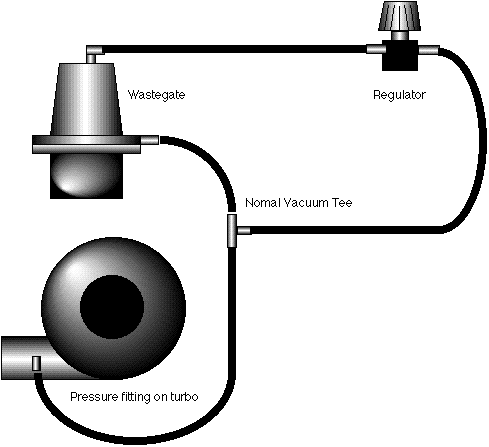

Vacuum hose to the wastegate look new, did you replace them? Explain how the boost controller is connected. Where does the controller get its reference...turbo is connected to the top port on the wastegate.

I have replaced hoses.
From what i can tell, its a loop. I assume the signal comes from below the wastegate, exhaust side..?
To the incab controller, and back to the top of the wastegate / turbo.

Try the Mitymite to pressurize the actuator.
Pressurize the wastegate 12lbs and see if it holds. If the diapham has a split in it it won't hold pressure.

Does this set up use the vac line from the turbo with a "y" connector. The y has to go a certain way or it will not boost over 10lbs, if I remember correctly, on a stock set up.
Steve, he's running the vacuum lines "tuner" style, not using the stock setup.
