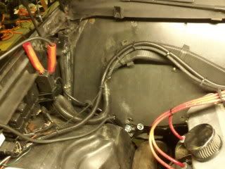

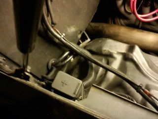

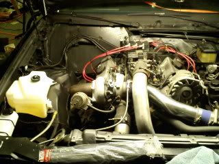

right now it has a little te53 3 bolt turbo. 3000 stall 9/11 lock up converter. 210 billet cam kit, scorpion rockers chrome moly push rods . I put it on the dyno the other night. It made 430 rwhp spiked at 17psi held 15psi. ATR wastegate screw bottom out. Right now I'm starting to fab some parts. Core support tranny mount bumper brackets . Going to make some upper and lower control arms front and rear. The AC and heater stuff has all ready been removed. Put a mini starter in the other day. Last night I installed a odyssey battery. I mounted it behind the firewall in the middle. Got a m3 e46 jump terminal and mounted it for charging and jump start. Lost 33 lbs from that alone removing the huge battery and the 15 feet of cable going to the truck.
some pictures
