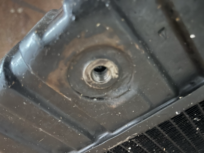

Re-cored radiator install - yes. Alarm system figured out so car will start - yes. Transmission cooler line fittings on grill side of radiator leaking - unfortunately yes. How do you get those 90 degree fittings clocked tightly into the radiator and in the right direction? I used some good sealant but apparently it didn't work. Can I use teflon tape on those fitting? I think the radiator has been in and out of the car more that I have since I bought it.
When my radiator was upgraded to the cold case, the curved lines that run around to the front of the radiator were put on first. Then they were attached to the long lines running to the transmision on the side of the battery. That is the easiest way to assure they are on straight.
For me it was easiest to put the 90* fittings on BEFORE I put the radiator in. That way I can tighten & clock them to the correct position to meet up with the cooler lines.
As for the fittings they should seal themselves. The thread should be self sealing(similar to the way the brake lines seal). The brass fittings are cheap enough if ya need to buy two new ones. Just be sure to get the correct thread type.
if I remember correctly those fittings are NPT on a OEM radiator. Loctite has a product 545, it will seal a pipe thread that you cut get one more turn to seal. BUT it must be clean and allow time to cure.

This is a pic os a OE radiator and fitting clearly 1/8 NTP
So the brass 90 is 1/8” Male NPT x Female 5/16” inverted flare

please confirm your OE has 1/8 NTP as pictured and not 5/6 inverted flare, If someone changed the OE cooler its posable to not be NTP.

I have the original radiator & the 2 original fittings. Ordered 5 more to see if the starter threads might let a couple of them clock differently so they fit tighter. That 545 stuff is kinda pricey. Worth it if it works.
