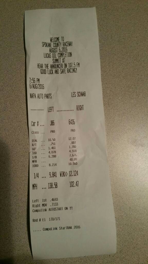

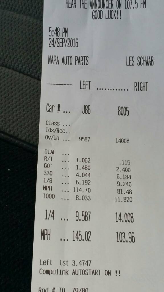

Update open exhaust on dyno 798 at 27 psi on e98 . Turned boost down 22 psi hit 23 psi a couple frames went 9.84 going to work on my 60 foot times now . Not to bad for a 3900 pound brick air quality wasn't that good 4548 elevation
Was only able to make one pass before bracket racing started My first pass I forgot to turn on co2 so I aborted that pass. So I guess at 10:50 LOL
What are you shifting it at?

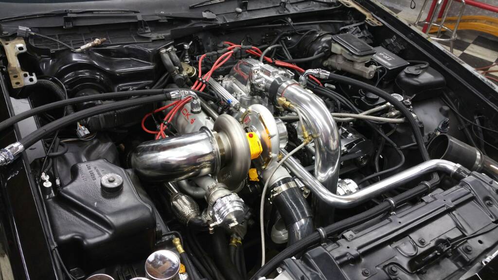

figured I would update this one even though I ran it a few months back .should be running faster with new setup next year . Precision 7675 vband 96 exhaust housing, RJC big 5inch tapers down to 4 inch downpipe, rjc 4 inch single shot exhaust, RJC big intercooler, and a bunch of other shit lol .now time to polish turbo and exhaust housing.
Bad Ass! I love it
So, what intake pipe are you running? I like it's route. What intercooler where you running b/f the RJC?
Turbo regal custom parts intercooler that's what I was running before RJC
How about the intake pipe?
