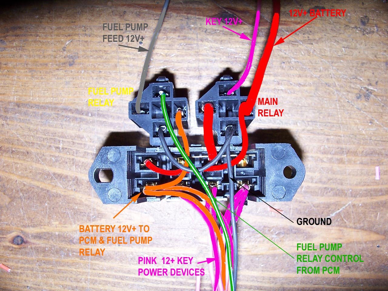

	Pink wire at the top. What should I run that wire to? I want a good source with a nice fat wire so that I won't overload anything.
Also, on the top left one that says "fuel pump feed", that one should go to the hot on the fuel pump itself, right? Bypassing the factory relay, of course...
