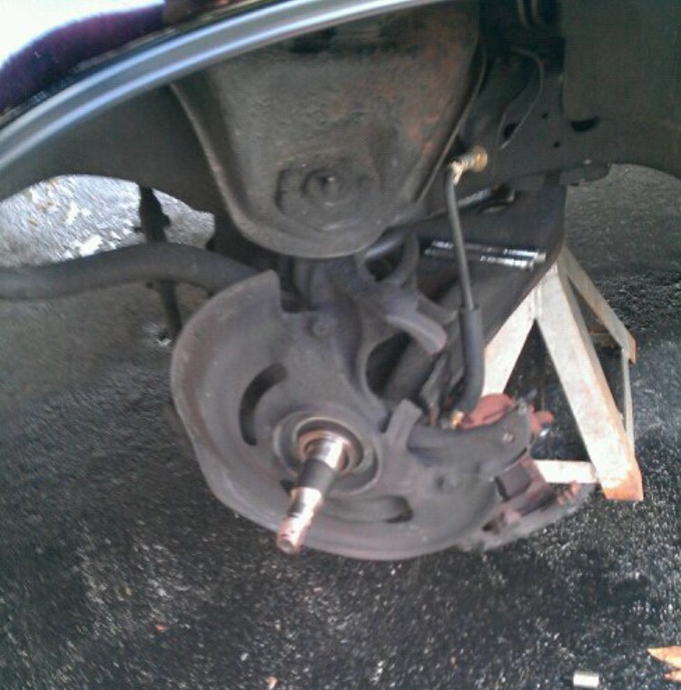

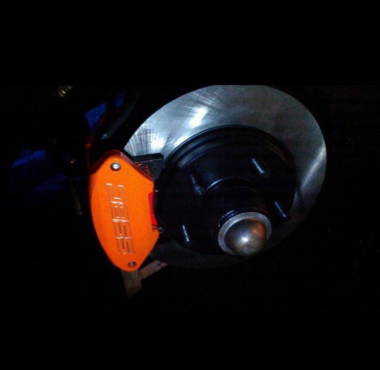

I've installed a SSBC kit on a GN and did not have to modify one thing! I used a set of centric rotors and there was no problem with fit and install.
The ssbc kit comes with pads they slide right on just have to be straight. The stock calipers are cut back a little more so they go in easier. I did the ssbc kit a few years back on a low mile car and stopping after the swap was really good!
Thanks for all the replies, the SSBC pad and caliper kit fits into my budget as I'm just looking to reduce some weight mainly and add some stopping power. I was just a little concerned when I read guys having to mod the wear clip for them to work/fit. Seemed a little ridiculous IMO
