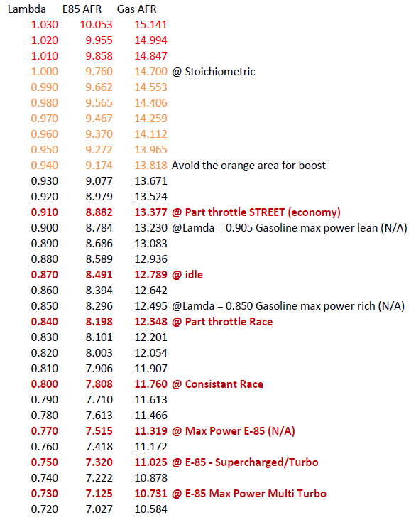

So, on straight E85, is it safe to start tuning at 10.5:1 A/F on say 23/21 timing? It sound like this may be cool to try but Im wondering if the Stoch is different then is tuning? Sorry if its been answered before.
Hi Jason, that is a good question. The Air Fuel ratio is dependent on the scale your A/F ratio instrument is using.
Most A/F instrumentation is scaled to gasoline. E-85 when measured on a meter scaled to gasoline for power would be between 10.5 on the rich side to 12.7 on the lean side, for an NA engine
Due to the various scales I am trying to just use Lamda which for all fuels Stoichiometric is 1. So the range for wide open throttle operation for E-85 under a Lamda scale would be .714 on the rich side and .864 on the lean side, for an NA engine.
I use the following table when comparing fuels.
I would be more aggressive with the timing unless you are at a very high level of boost.
