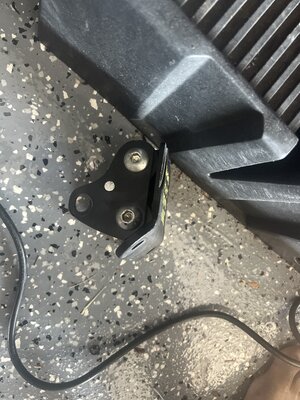

Got the old one out. About to go for the new one. A bit easier than expected, but I am curious to your comment about the Allen’s can be a pain. These are the only Allen’s I see and they are already attached. Do they come out or something?
Got the old one out. About to go for the new one. A bit easier than expected, but I am curious to your comment about the Allen’s can be a pain. These are the only Allen’s I see and they are already attached. Do they come out or something?View attachment 399781
The HR mounts should come with 4 allen(cap head) bolts. Two for each side. You get rid of the factory mount bolts & use the set they sent with the new mounts.
