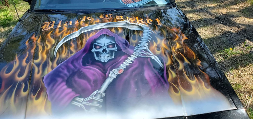

Started looking for another, but nothing was coming up that was workable and priced right. I kinda gave up looking for one, until I saw this thing in all its glory. Covered in flames and a Grim Reaper, it was interesting to say the least. Went up to Maine to check it out.
Turns out an Army recruiter drove it up to VT from TN, and the sellers Dad had to have it. Made him an offer and bought it on the spot, and immediately customized it. Unfortunately he passed away, and left it to his son. He took good care of it, keeping it 100% rust free. It was time to sell it, and I guess I was the first to see it in person. He knew I was going to repaint it, and was sentimental about the hood. It had his children's initials on the scoop, so I let him keep it. I knew I'd feel bad painting over it knowing how much it meant to him.

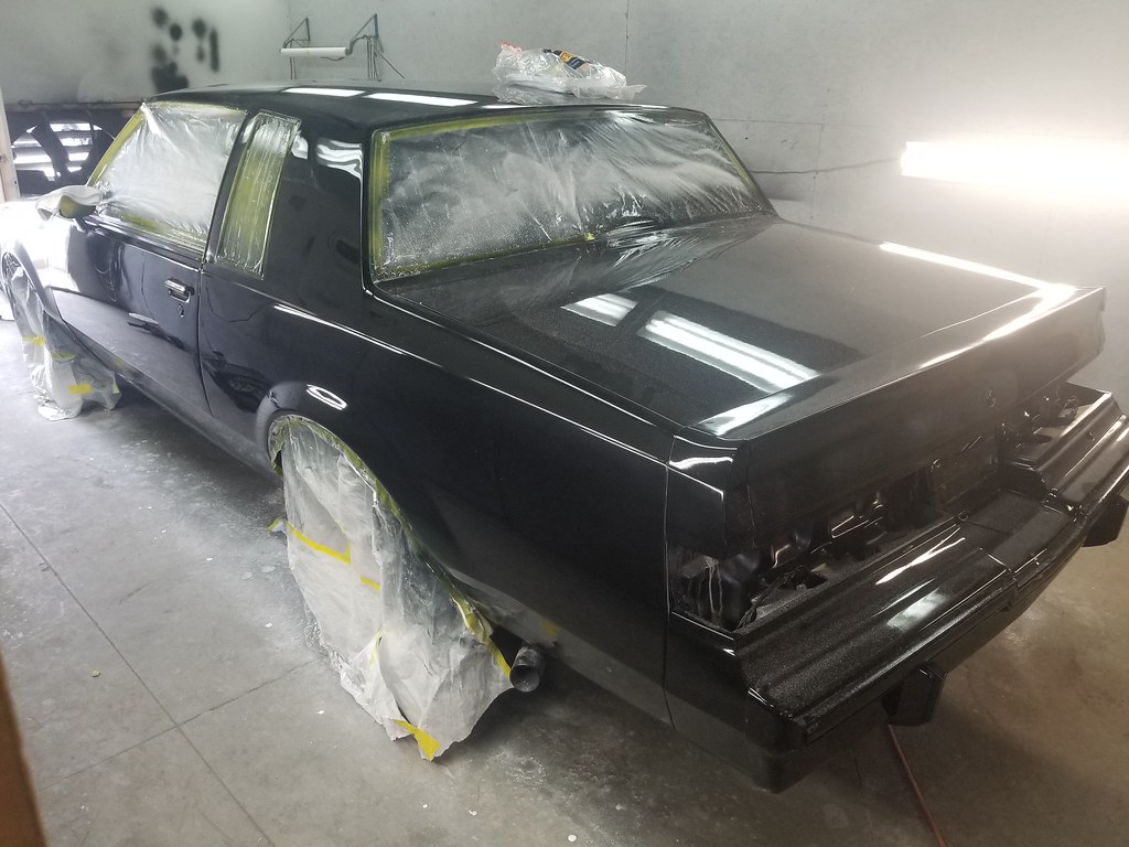

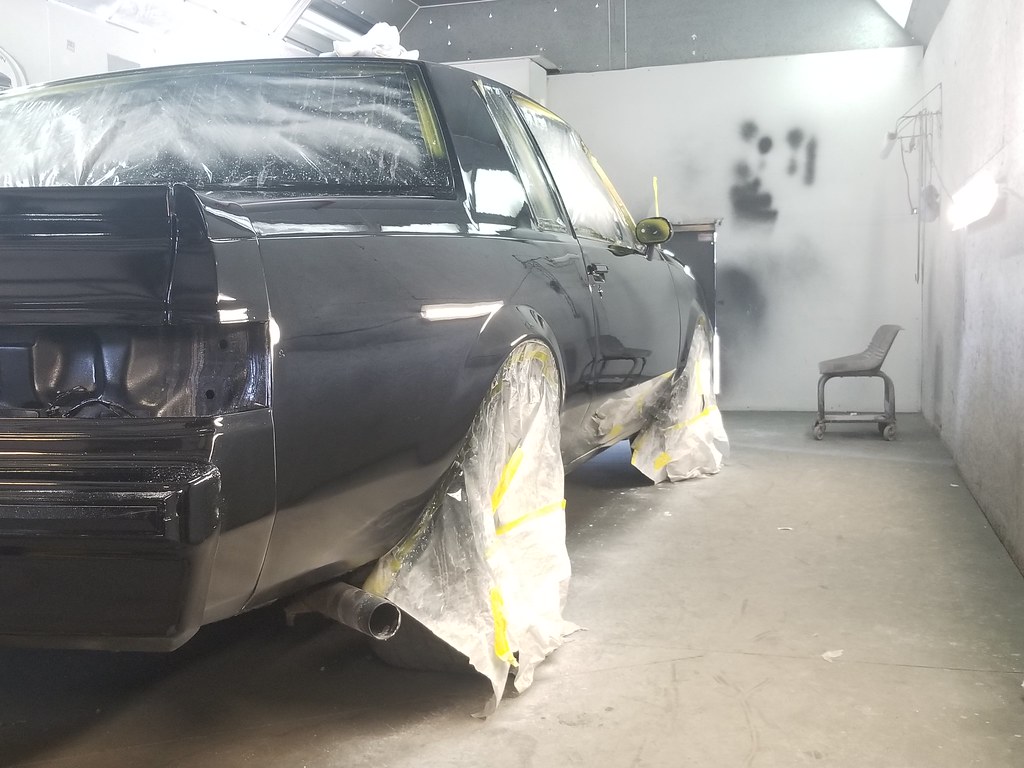

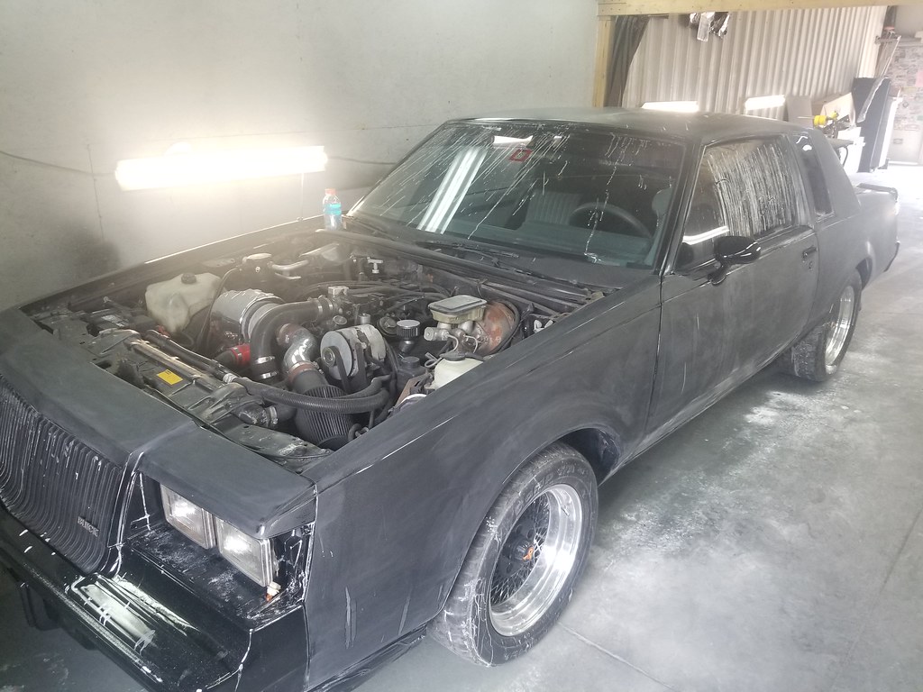

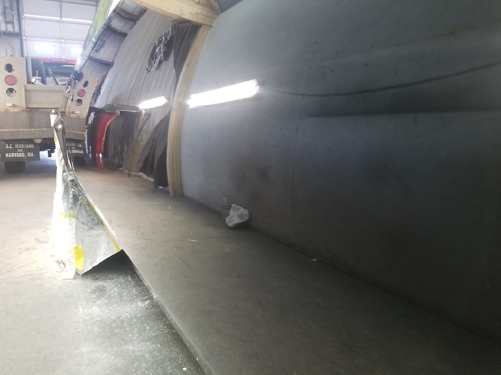

Just got done with the paint. It's a base clear, including 3 coats of clear which were cut down with 800 grit, followed by two flow coats of clear which were then cut with 1200 up to 3000 grit.
Heres a few pics of the progress. Next up is redoing the tint (it's waaaaay to light) and some other odds and ends.

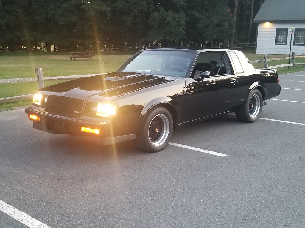

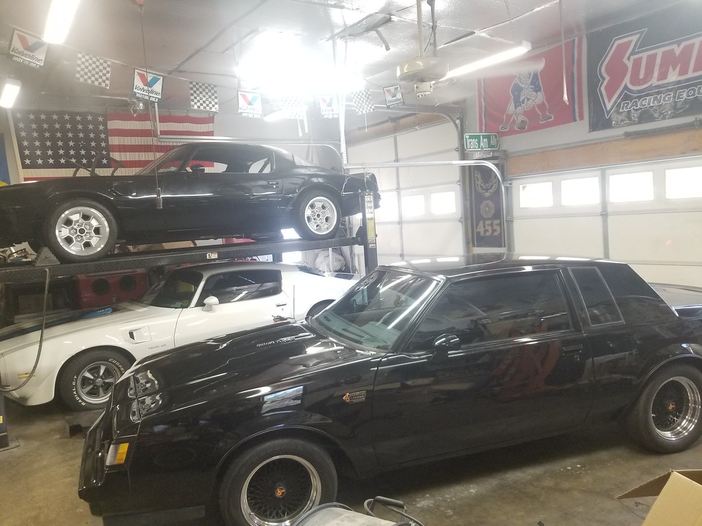

Took it for its first drive down the street since 2014. Snapped a pic before the sun was totally down. After that I redid the tint. Went 5% on the rear and quarter windows, 35% on the doors, and an 8" 5% eyebrow. Looks so much better than that old blueish tint.
Stunning! Looks great.
Those your 2nd gen TA's? That's a bucket list car for me kinda like the GN.
Yeah, I have a few of them. Pontiacs run in the family.

Honestly, I like "your" paint job and wheel choice much better. Very nice.
That hood was atrocious. Was the seller a mortician and wanted it for a coffee table. :LOL:
