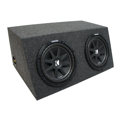

I ran two 10” kicker comp subs and a crutchfield amp (2x100 rms) that was very loud, rattled the license plate and trunk lid. I can’t see why anyone would “NEED” more.
I couldn’t find much info on the setup in the link, so I’ll start with this.
Match speaker ohms with the amp. If you run 2 ohm speaker on a 4 ohm amp you will overheat the amp at higher volumes because the 2 ohm load is closer to a direct short (0 ohms) than 4 ohms.
If you run 4 ohm speakers on a 2 ohm amp you won’t hurt anything, it just won’t be as loud as it could be.
Subs with 2 voice coils have 2 voice coils so you can have a left and right channel in the same speaker or you can better match the sub to the amp by running the voice coils in parallel or in series or by only using 1 voice coil.
Select a sub with an rms power handling capacity just above the rms rating of the amp.
A sub with a higher sensitivity rating (the higher the better) doesn’t require as much power to sound good. Most are 86-88 and some are as high as 92.
Subs also have a rated box volume size. A sealed box will provide tighter (more accurate) bass, where as a ported box will be a little sloppy (boomy) and slightly louder.

FWIW a dual compartment box at 1.25 cu/ft per sub will fill the whole package tray in the trunk (upper level).

I found some Pioneer 12” subs made for my 1.25 cu/ft per speaker box because well, you know, bigger is better right? They were almost as loud as the 10” kickers and not quite as tight.
I recently got some 12” kickers that are free air subs that will work with my box, no results yet.
I was surprised how well the 20 watt amp added to the sound. It was enough to vibrate the inside rear view mirror.
This would be a good box setup. You’ll have to check the measurements to see if it will fit the way you want.

I believe the 43C104 are considered free air subs and can be mounted to a panel behind the back seat. You would have to seal everything off including the rear deck, 4x10’s and all.
It would definitely be easier to build a box to put them in.
