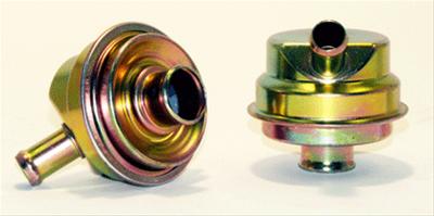

head to your favorite auto parts store and head for the bling section.. somewhere in there- wedged between the Mr Gasket 14" round open element air cleaner and the fart cannon mufflers you will find a couple of different breathers to choose from. measure the hole in your cover and pick up a grommet while you are there, too. the breather might even have the proper grommet on it.
if you don't want a cheap chrome breather or can't find anything there, get this.. Wix part number 42997.. and whatever grommet you need.
http://www.summitracing.com/parts/WIX-42997/?rtype=10
there are also variations of this basic breather that screw into a stock valve cover, but i don't know what application to look up for those.
i also just remembered that some V8 Fords in the 70's and 80's used an oil filler cap that had baffles and a grommet for the pcv valve.. something like that could also work for what you are doing.
