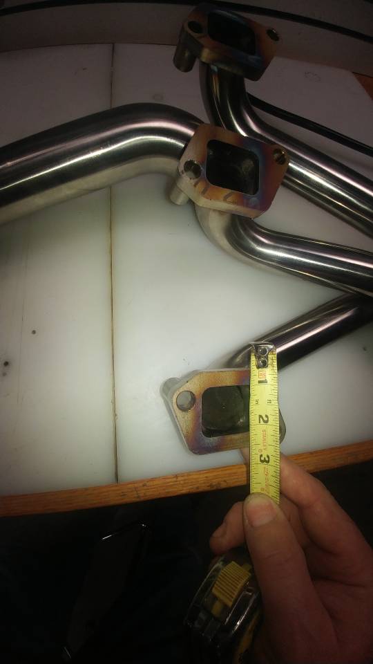

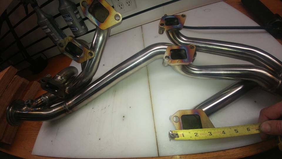

what size openings are on the header flange?and what size downpipe?
