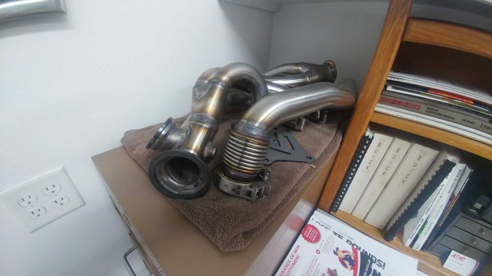

I'm also not even sure if they put the vband in the correct location, as I am wanting it to be in same position as stock turbo. I have a tig welder, so I can also redo it if needed.

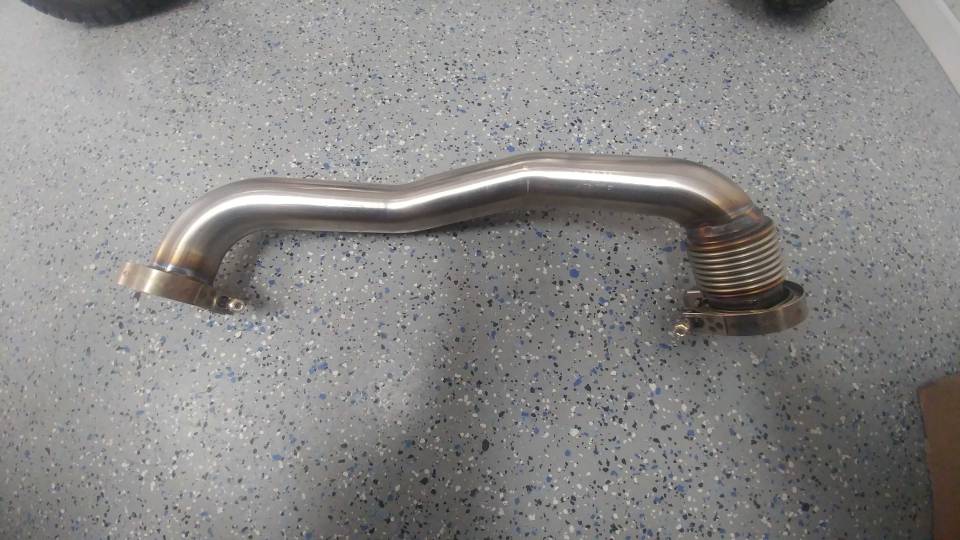

Is that pipe to the right your downpipe? If so, where did you get that from?
What Is that opening right below the v-band flange for? The opening just below the mount for the turbine housing. Is that an external wastegate provision?
Yes, external wastegate. That is their new crossover with flex joint.

Where is the crossover pipe?
Those headers arent twin scroll. The way your response was, it seemed like you were saying that you were getting twin scroll headers.

Hahaha so they FINALLY listened to us when we said that the headers wouldnt bolt down if the crossover was connected.
Ive had so many issues with these headera that they refused to fix, or wanted us to ship the headers back to Finland, that I stopped selling the headers altogether. I refuse to put my name on the line for a product that has repeatedly arrived incorrect and requiring custom modification in order to have it fit correctly.

Exactly. I will let you know if these line up correct. The flanges do look flat if I hold a strait edge to them, but not sure if the locations are correct.

Its not the flanges being flat, is that when you bolt the headers to the heads, the flanges dont sit flush against the exhaust ports. They can be up to 1" away, and the bolt holes on the flange will not all line up correctly. You may have to force or bend the flange/piping in order to get it to fit, which you should NOT have to do for headers this expensive..
