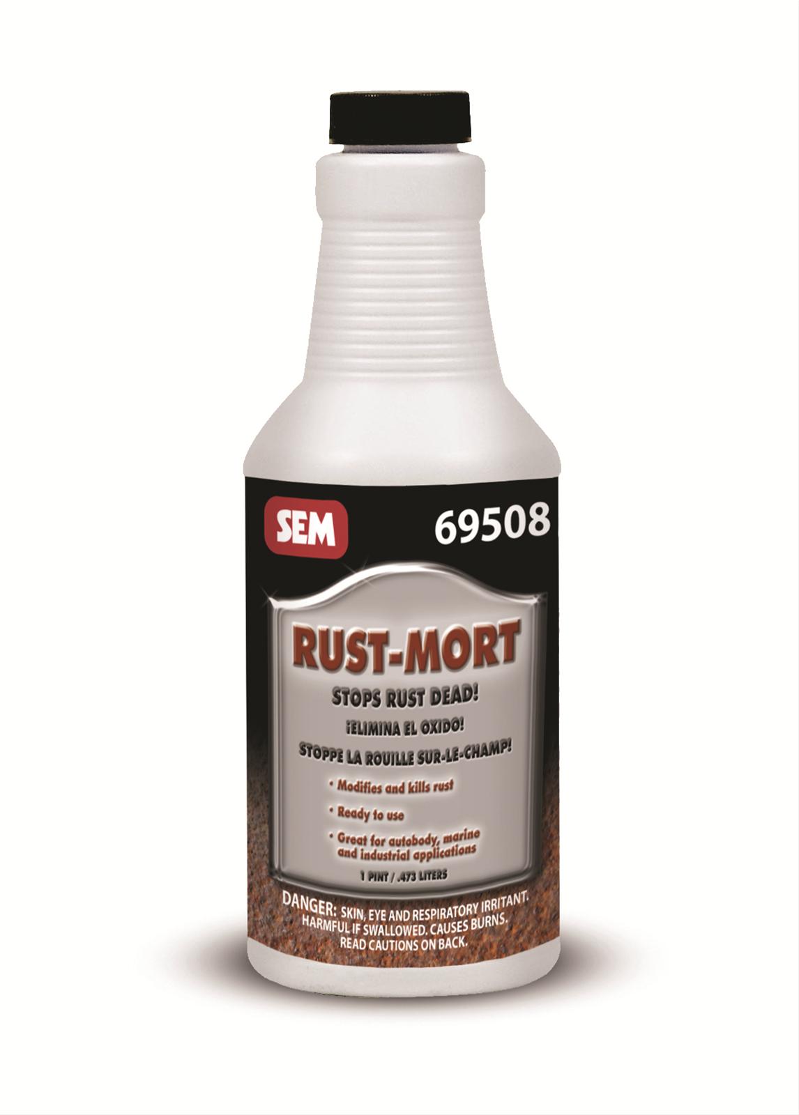

after degreasing and wire brush rust remover or muriatic acid. Be cautious if you use acid it burns if it splashes on you.
I've used this stuff for years, also use it after blasting just as a extra prep before painting. It burns if it gets on you too. I've put in in a spray bottle with a little rubbing alcohol to thin it to spray into hard to reach areas.
