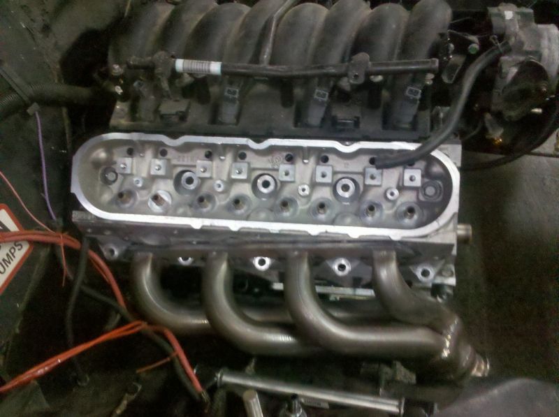

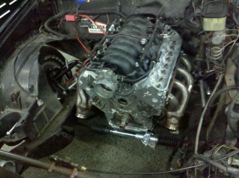

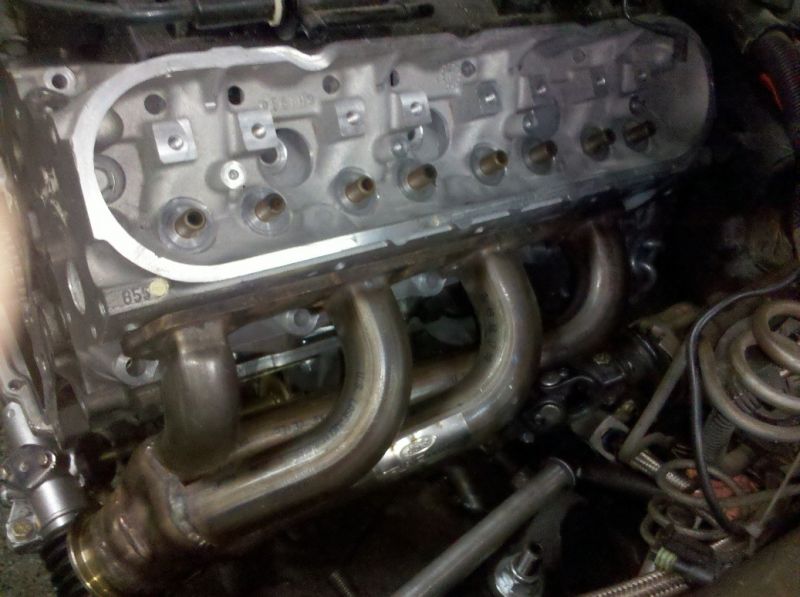

We mocked up the FMS headers and we think they will work. They definitely need plenty of modification, along with the new flanges, so I understand why the other fab guy was not willing to make them without a car being there. All primaries have to be shortened on the flange side around 1 inch. They header also has to be welded to the LS flange at a slight angle in order to clear the steering shaft on the driver's side and the cradle on the passenger side. Here are pics taken with the headers just laying in place:
They look like they fit, but they don't.
This is the driver's side, you can see it smashed against the steering shaft, and it's not even far enough back to line up with the head.
This is the passenger side, you can tell that the bottom of the header smashes against the cradle, and the v-band has to be completely cut off, and a bend will have to be added to the header right after the collector. I think it will be a slight challenge for Pat to make these work, but we're going to try it before I ask him to build custom headers because this is supposed to be a budget build.
