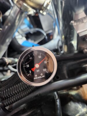

I get Rick L on the board to take in my problem child, he starts with drilling the oil pump and gets a solid 95psi, no fluttering. I'm getting worried he's gonna think I'm nuts. LOL
Rick adds oil line with gauge to windshield, sees I'm not nuts, dropping pressure ONLY under load/rpm/boost.

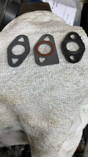

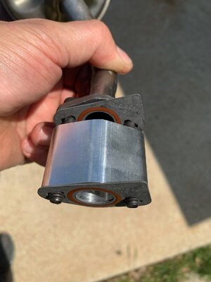

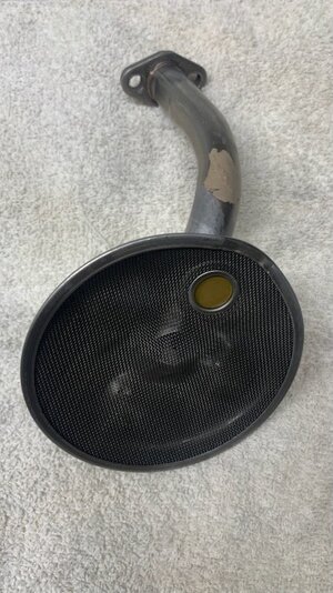

Rick drops pan, WTH people = Pic 1
A hand cut plastic oil pick up tube gasket center hole opening, 12 bolt arp bolts that are somewhat loose and a lube I don't recall but he thought was odd.
Loose bolts and a hand cut gasket?
How is this on a new engine?
I think there's 2 scenarios that maybe happened but no proof so onward.
New Part Solution
Factory gasket and oil pick up used, problem solved, now Steve D knows 2 guys with this stupid $15 issue.
