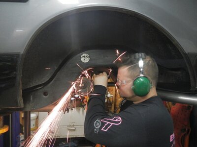

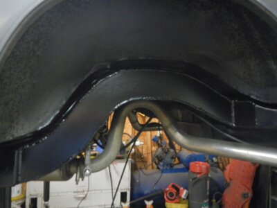

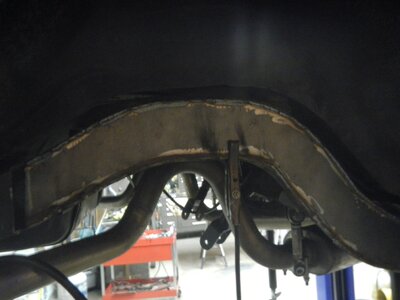

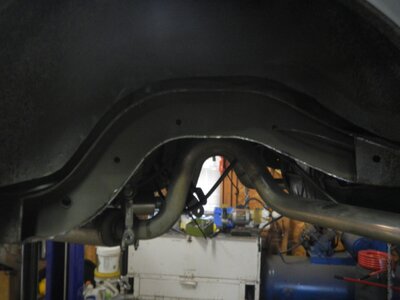

My 9" is narrowed 1.5" each side with drum brakes . my wheels are 15x10 with if I remember correctly 4.5" backspace . I did a frame notch that brought the frame face flush with the wheel tub . I had to massage the upper wheel tub with a sledge hammer to gain the needed clearance because the upper tub tapers in slightly . The fender lip is rolled also .

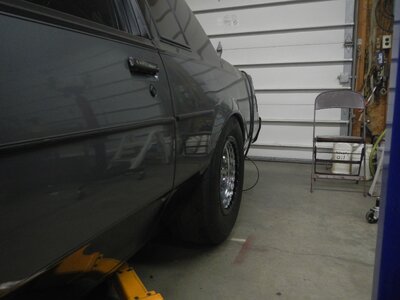

I had this tire on and also a
295/65-15 . They were tight .20251209_133542.jpg
Looks like they did a nice job, and the tire is sitting in there just right. That's a nice size tire too.
The reason i'm asking is because I ordered a set of rims with a 4" bs and was second guessing myself if I should have gone with a 4.5" bs and maybe a small spacer if needed. I may just have to roll the lip and call it a day.

The frame notch was easy , that's my son cutting out the frame . We used 1/4" plate for the notch . We used the cut out piece of frame as a template & traced it onto the 1/4 plate then cut it out with a plasma cutter . A little grinding to fit and welded it in .
