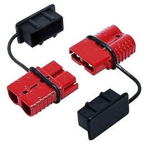

Take the whole battery out and call it a day.
wire it in with a plug like this:
and a couple of wing nuts on the hold down... works for the NASCAR boys..
I like it! Maybe just cut the cables with an axe?
No axes are to be used on an american classic... my comment wasn't intended to be taken as a smart ass remark but its always better to play it safe so removing the battery eliminates the risk.
