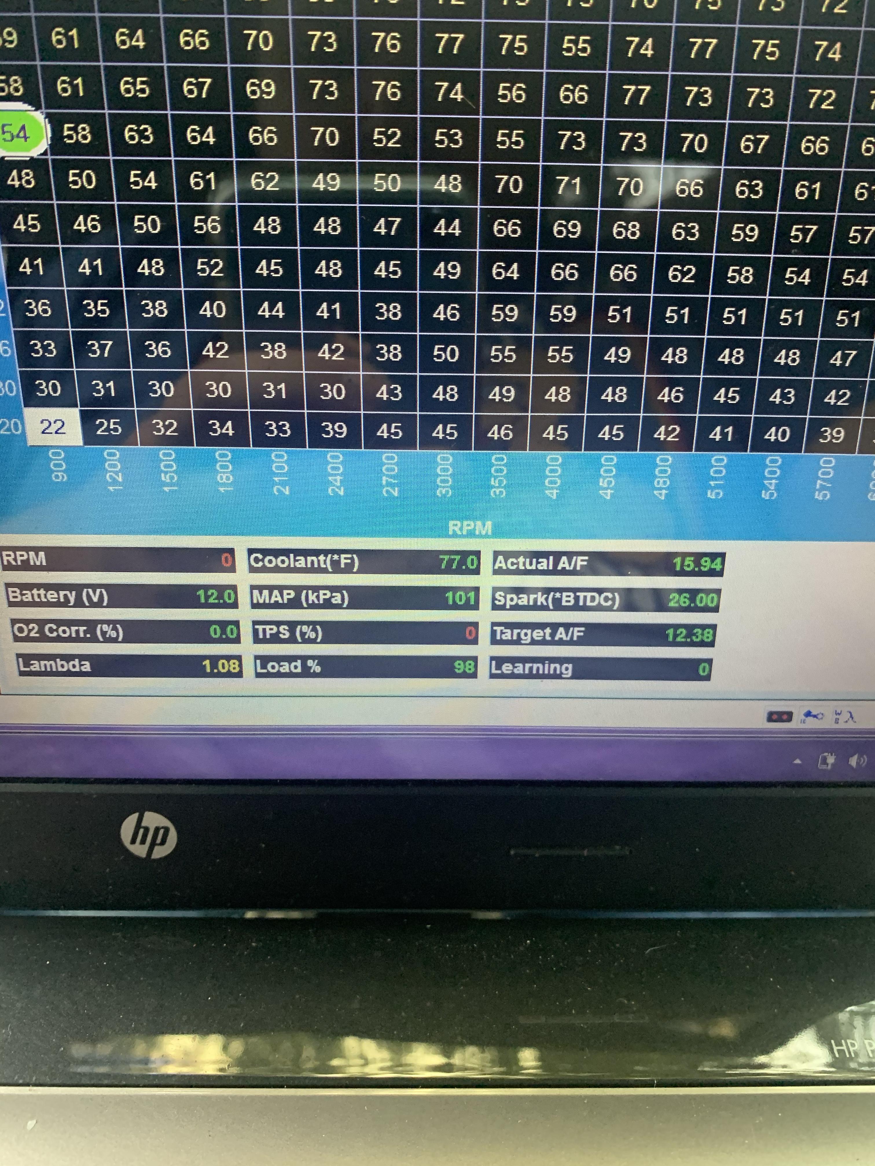

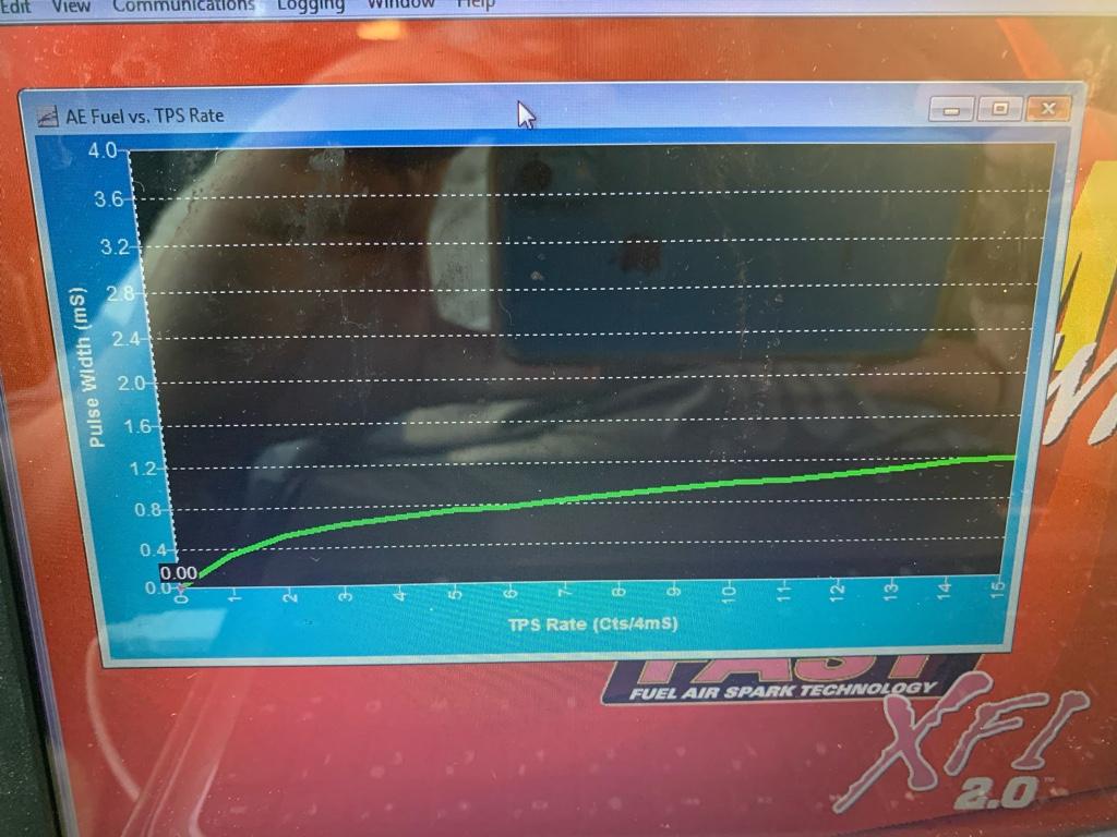

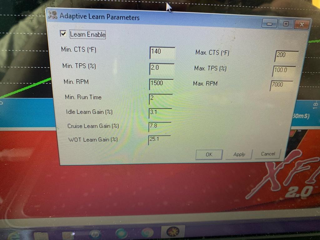

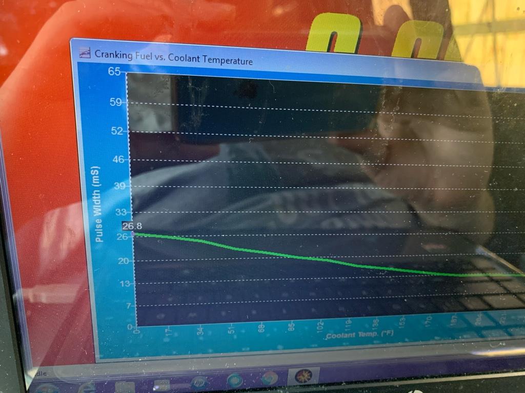

We are trying to get this. I assume this is what you mean?
No. Get your laptop connected, then tell me what the MAP kpa is
Sent from my SM-N960U1 using Tapatalk

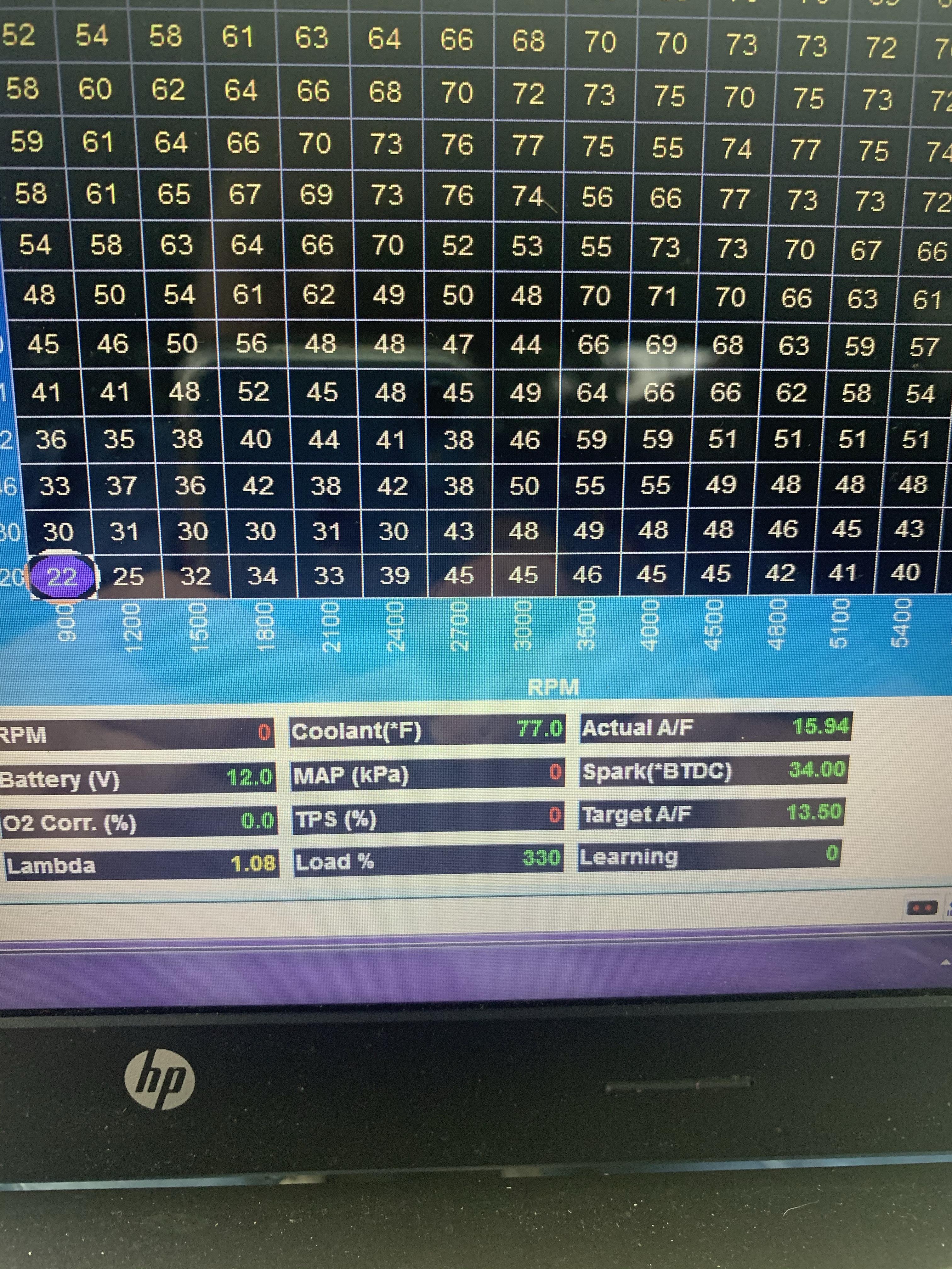

The first is when it is sitting. The second picture was at a cranking activity.. I could not replicate this.
In addition to the MAP issue, I'm not seeing RPM in either screenshot. You said one was during cranking? Perhaps your laptop became disconnected on the top screenshot

Is it possible that the rpms were not showing up because it barely ran (maybe 1 second)?
I will change the MAP and report back.
