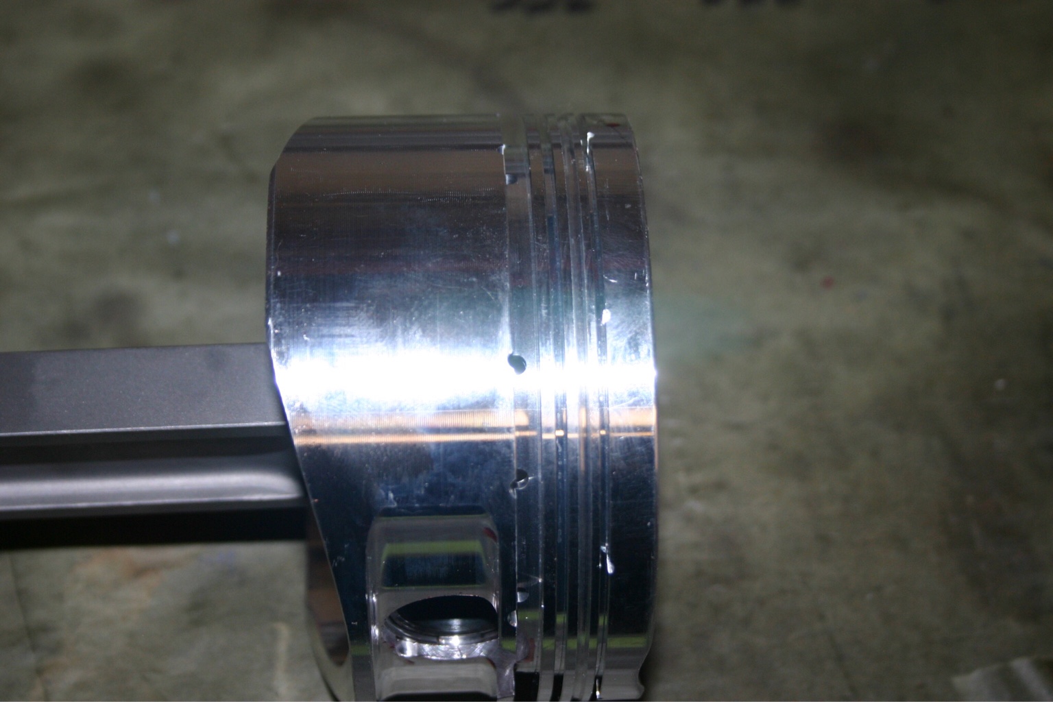

Was able to dig up this picture.

What is the stroke of the engine these pistons and rod are in?
3.59 stroke with 6.5" rod. Based on the measurements they should work with a 3.625 stoke and will bring the piston closer to 0 deck. .
AG.
They are, and if you have six of them laying around you could send them to me so I could put one in every room so I can admire them all the time.;);)
I had this same reaction to a direct drum that Bruce at PST Extreme sent me years ago. I told him that I didn't want to put it in my transmission because I though it belonged on my fireplace mantel.
